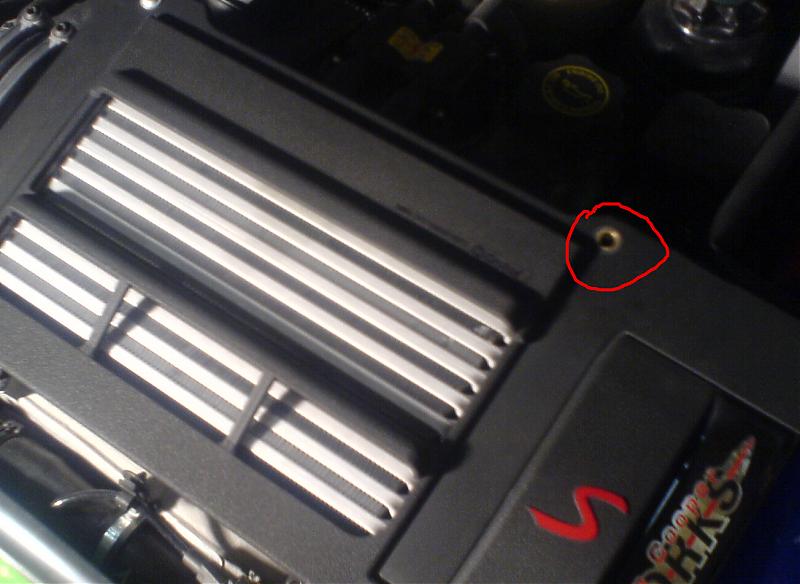

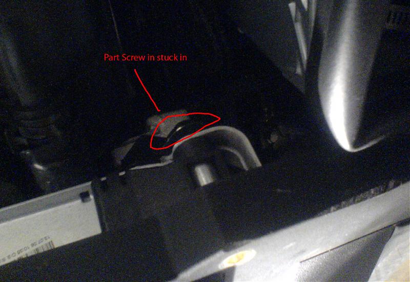

I don't know if this has happend you anyone els.
I was cleaning under the hood and found a loose screw on the intercooler. I tryed tightening it but it was broken. It was my top right screw. Has anyone els had broken screws? I'm going to order new ones from mini.
The bottom part of the screw broke off in here --

tightend to hard? those screws are not very strong from what I saw.

Does anyone know the best way to remove that striped screw from my intercooler?

How much of the screw is left? You may just be able unscrew the other 3 and remove the intercooler. Grab a set of pliers and unscrew. Or have you already tried that?
unscrew the 3 left, Remove diverter. unscrew the 2 brackets in front of the intercooler (where the 2 front screws screw into) unscrew and remove the 4 intercooler brackets on both sides and pull up to remove inter cooler. grab pliers and unscrew. Put it back together and make sure boots are on correctly. tighten down the screws.
