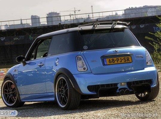

You only have to cut some of at the front of the R56 panels to fit them on a R53, I have fitted them. If you want to it nicely you can also fit the brackets (No 5) of the GP but if you do not fit the R56 diffusor they are not neccesary.
Here is my setup.
To my knowledge there is nog difference between the R56 and R56 JCW underbodys.
