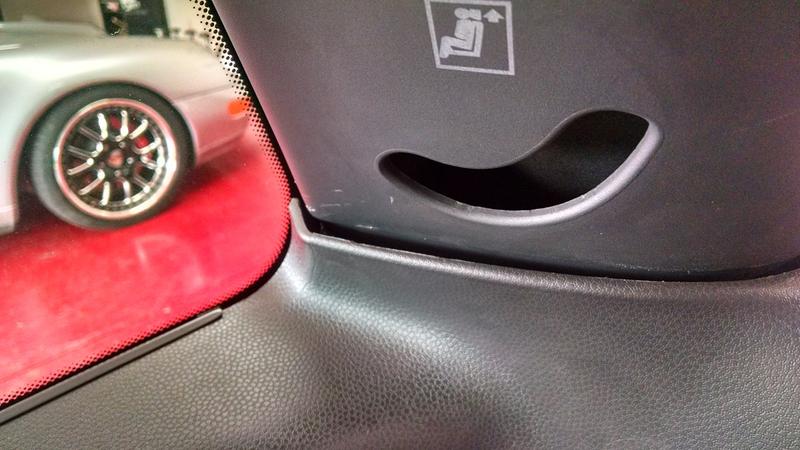

Gave the GP it's first bath today and noticed this (see picture) couldn't seem to get it to sit flush, do others have this issue? Any ideas? This is in the rear against the passenger side rear window....could the plastic just be deformed? The driver side rear looks fine.

For your panel, mine fit flush. I suspect you have a broken clip or two. The clips break easily if the panel was ever removed. Use the OEM links provided above to find part numbers. If no Mini dealer near you, I might be able to get at a BMW dealer because the BMW and Mini P/N might be the same.

Clips: Pull off the cover and see which ones are broken. People full the covers off and then tend to break the clips.
#9 Clip - Priced Each Yellow 07131503417
http://www.ecstuning.com/Search/SiteSearch/07131503417/
#10 Clip - Priced Each 07130766476
http://www.ecstuning.com/Search/SiteSearch/07130766476/
#11 Spring Clip - Priced Each 07149198818
http://www.ecstuning.com/Search/SiteSearch/07149198818/
