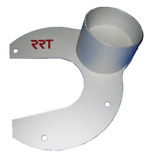

LDG installed the brake air ducts yesterday, they did a great job and they work beautifully.They seem to be always working at their best now, especially at high speeds, no fade at all and even more responsive. The install took roughly 4 hours, it was worth the drive to Lucky dog garage to get them done along with a couple of other projects they did for me.
Waymotorsports.com supplied the air ducts.
Brian after removing some of the back of the spoiler shows how the duct will attach to the back of the original air vent and that with the GP you don't need the adapter plate (as I call it) shown in the picture.
He had to partially remove the inner wheel arch and cut it to accommadate the duct.
The duct installed before putting back the inner arch.
Next the inner arch was put in place and everything was secured. You have to look carefully at the vent to see that is now functional

Was there a backing plate behind the rotor before starting the job? If so, was it removed by LDG?

Yes there was and still is a backing plate behind the rotors, its hard to see it in the pictures, but I did check today to be sure

It would seem to me that the backing plate would diminish the airflow to the rotor, and diminish the cooling effect of the duct. Is this incorrect? There are replacement backing plates which direct airflow to the rotor vanes, and hence cool the rotor efficiently, but of course I have no personal experience with such items, have just read of them.

There is an opening between the caliper and the rotor where the cooling air enters. The backing plates do not need to be removed and they actually serve as heat shields to the wheel sensor and tie rod end as well as the lower ball joint. The setup that we use for the track are the two piece floating hubs on the front. This way the heat in the rotor is not transfered into the wheel hub bearings and caliper.
