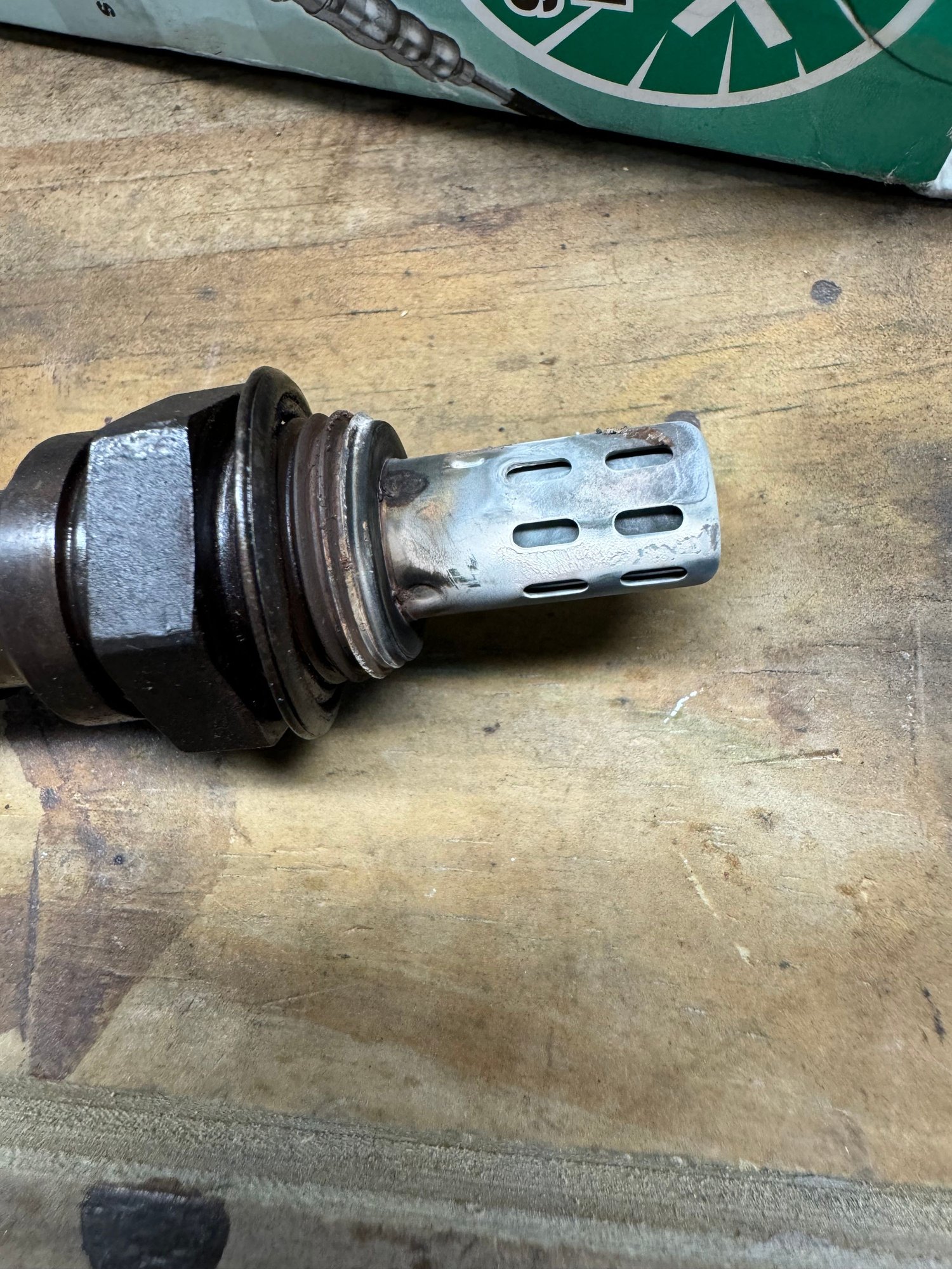

Here’s a pic of the old downstream sensor. It was definitely bad. Although I’m sure you could tell by the looks of. The upstream one was solid white. For fun I swapped the old downstream into the upstream port and the signal was 0 and never switched.
As far as the strut bearings go I noticed some leaking from them. So…I’ll be replacing the struts as well as new bearings. That should solve it.

Hey - Thanks for uploading the image!
Yep - both of my 02s' looked about the same white-ish in color. Car always ran great and never any fault codes or SES and live data voltage and fuel trims were in spec.
I going to assume the white condition is normal and is of little concern (in my case).
