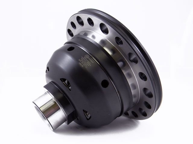

I like the Quaif also... but am leaning towards another brand .... WaveTrac.
For me, with a stiff setup (Ohlins R&T, 18's, swaybars etc).... wheel lift in real-world road driving.... The wave-cam to me makes sense.
For me.... I think that this ATB-type LSD is the best fit.... for ME, better than a clutch type LSD.
I've found this WaveTrac 56.309.190WK for as low as $800-ish online
https://www.youtube.com/watch?v=dV9gJJz-3gs

If you are pulling the trans it is clearly the best time to install the LSD, because after you go through the work you'll realize you don't want to do it again.
The Quaife is freaking great and requires no maint ever, I've had one in my race car for like 13yrs now and beat on it with no failure.

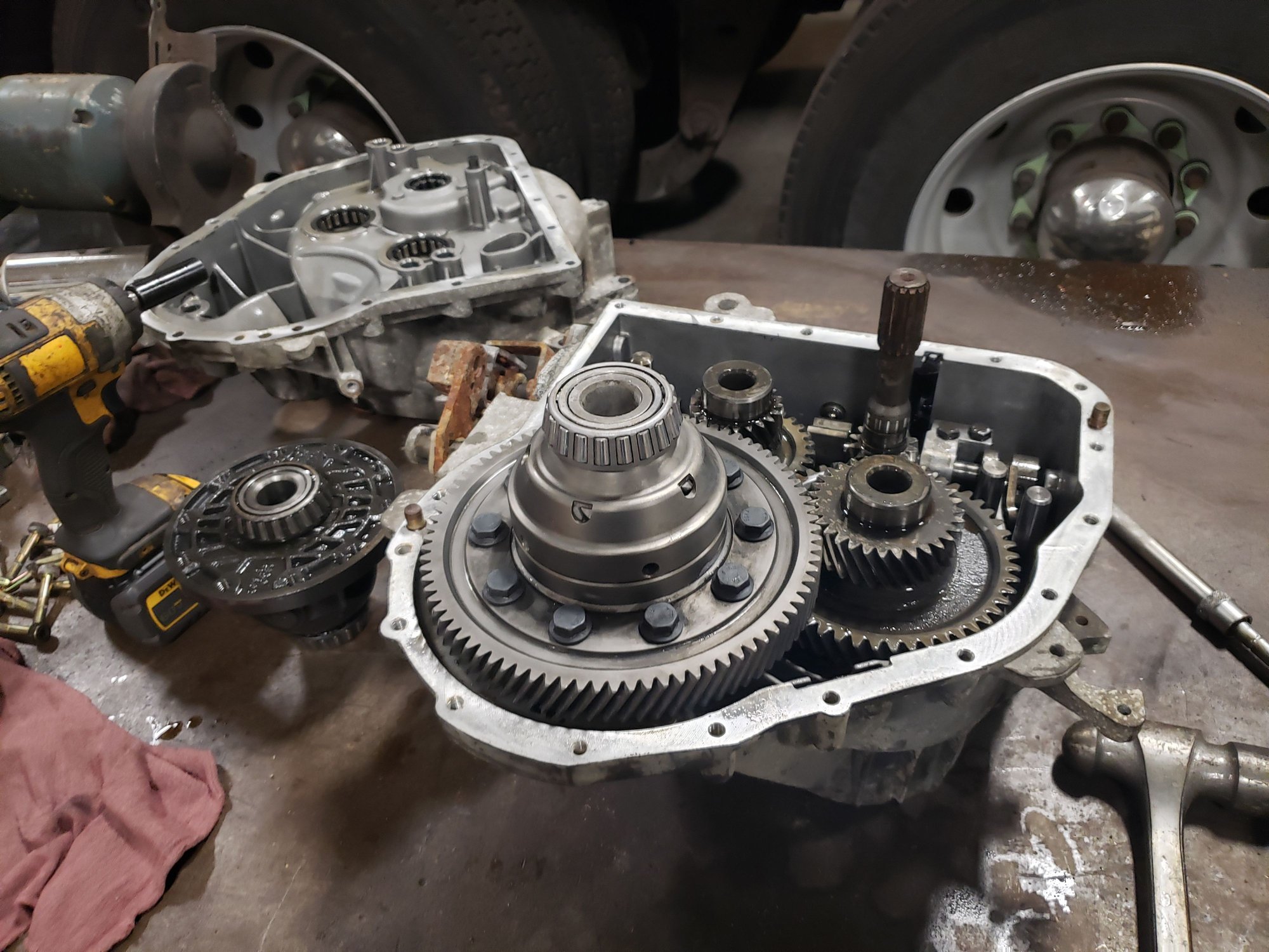

I recently installed a Valeo clutch kit and a M Factory helical lsd on my R53 and I am quiet happy with it so far, I only have around 2000km on it so far but its working well.

Ok guys, so I got the LSD and Valeo Clutch installed. I also had the shop install poly bushing transmission and lower engine mount inserts.
Question, is it normal to experience a light thud/clunk when releasing the clutch just as it engages? The best I can describe it is it sounds like a rubber mallet hitting pavement, not very loud at all but noticeable to me. Is that because of the inserts? If I shift very carefully, it doesn't do it but that's when I'm almost slipping the clutch. It's like the grab is aggressive, I hope I'm making sense. I am not able to replicate it when in gear and stepping on the gas. It only happens when shifting. right at the end of the shift process.
I'm really liking the clutch pedal feel though and the LSD really pulls the car in the corners. it is almost a weird sensation.
