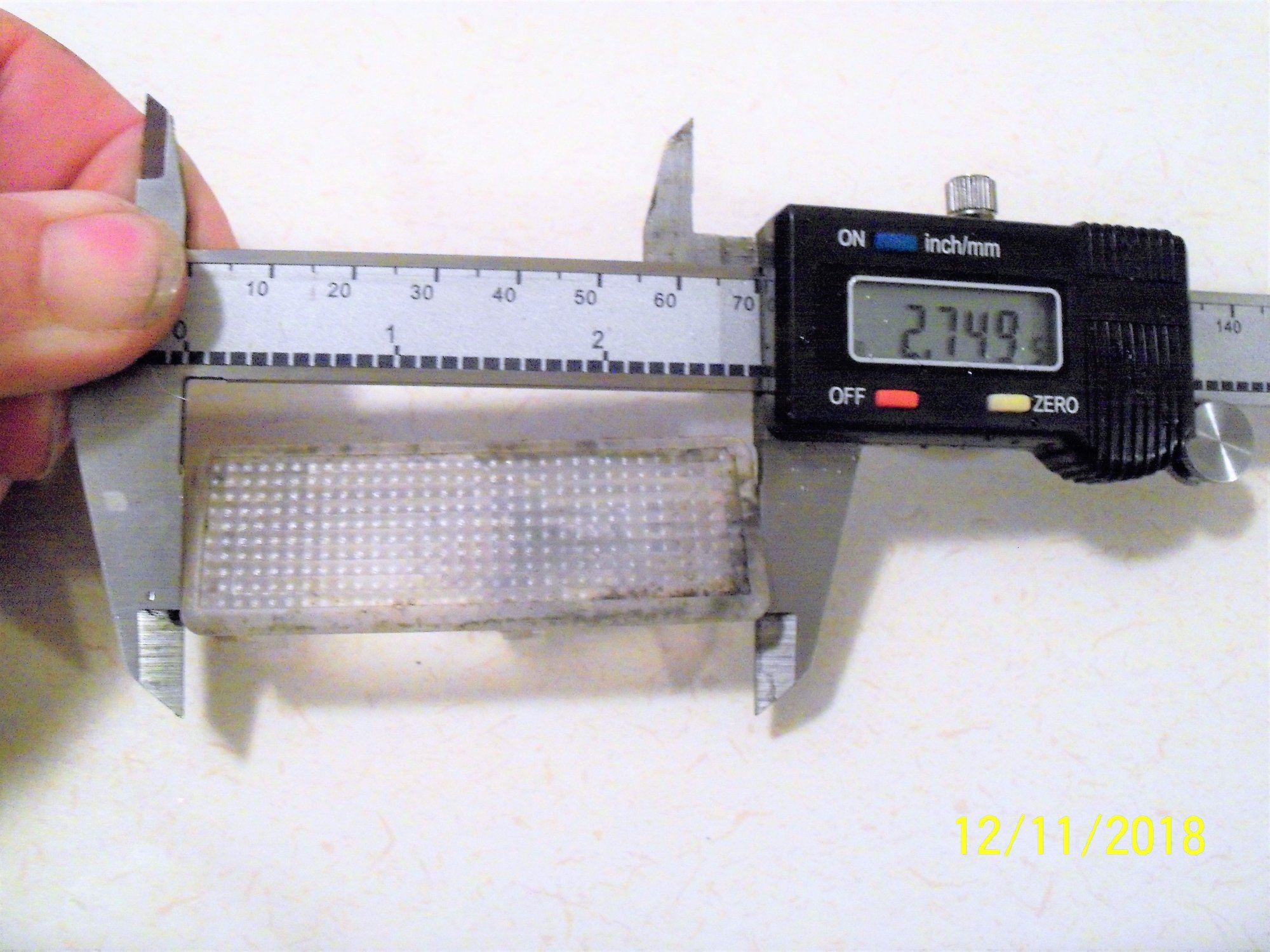

2) Will the Gen 2 or Gen 3 lights fit into my '06 car? Mine has just a regular 194 bulb, I have ordered a set of LED bulbs for all the interior lights, glove box, & trunk light, but I wanted to get a pair of puddle lights off a newer car that has the "MINI" logo for my R52......pictures below with the lens measurements for reference from the lights in my car

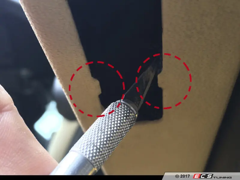

7/2004+ got them. You would have to run some wires down there through the door harness and tap into the power turn on or interior lights.
https://www.ecstuning.com/Search/Sit..._puddle_light/
On go badges you would need to trim the old ones like this if you have the opening on an 7/2004+. On Pre 7/2004 you would have to trim out a rectangle like the one on your R52.

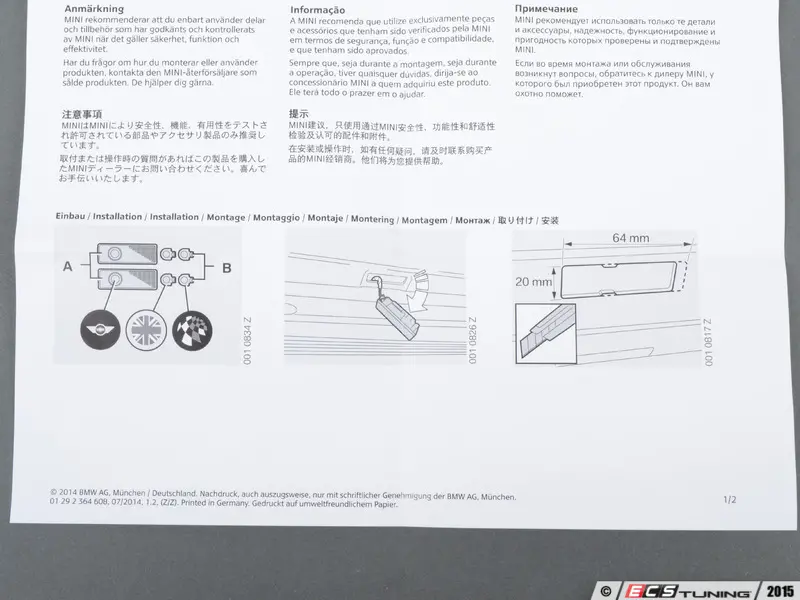

MINI factory Puddle kit, look at the DIY kit :
https://www.ecstuning.com/b-genuine-...t/63312414106/

Thanks for the info, my '04 R53 was made 10/03, so I guess there's no wiring in the doors for the lights. I may not bother putting them in the doors because of the hassle of running wires to connect them.
I found a pair of lights on eBay that have the JCW logo project on the ground, but they say that they are for Gen 3 cars, but the pictures look close to the same size as mine in the '06 car. Maybe I will take a chance, I asked the seller for measurements, no reply yet.
