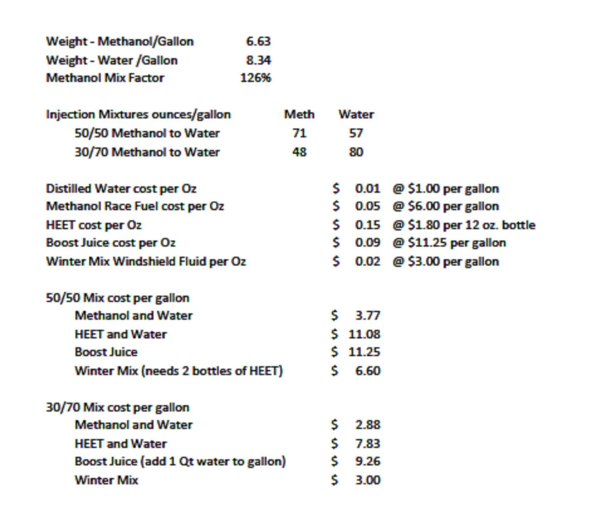

This thread is not for those that are using 100% or tuning for meth but rather cannot find meth for $5.30 a gallon as I can. Usually the nozzle screens are around 80 microns and the filters are around 40 microns. If you prefiltered the winter mix (no detergent and no glycol) with a 5 micron filter you would have around a 30% mix of meth (by weight) with allot of the minerals removed from the water. The vacuum/boost of the engine may also have a positive affect on the nozzle not developing scale that leads to blockage.
Below is a chart I made up that provides costs of different mix options. A 5 micron garden hose filter is around $15 and with some misc. fittings, a "funnel filter" could be made pretty easy. If I could not find methanol race fuel in my area I would use a filter and create a more purified washer solution to use. In the chart I tried to round things off based upon some "shopping". The costs are not exact but you should be able to get a good idea what is involved.
