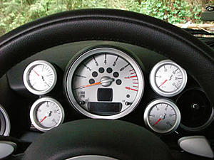

I have, I used the Cravenspeed gauges and adaptors. It isn't hard, there is a rubber octopus looking thing on the firewall that you can route your wires through. It is just above the brake pedal.
I put a boost gauge, water temperature, oil temperature and oil pressure gauge on a home made mount, made of 1/16" aluminum and 2" ABS drain pipe the mounting screws on the gauges hold everything together.

DneprDave, really appreciate the response. (Did you have to take up the center console to wire in?)
BTW, your car looks fantastic. Great work. (You should think about marketing your work!)

I tapped into a light in the console to power the lights in the gauges, so yes, I took up the console.

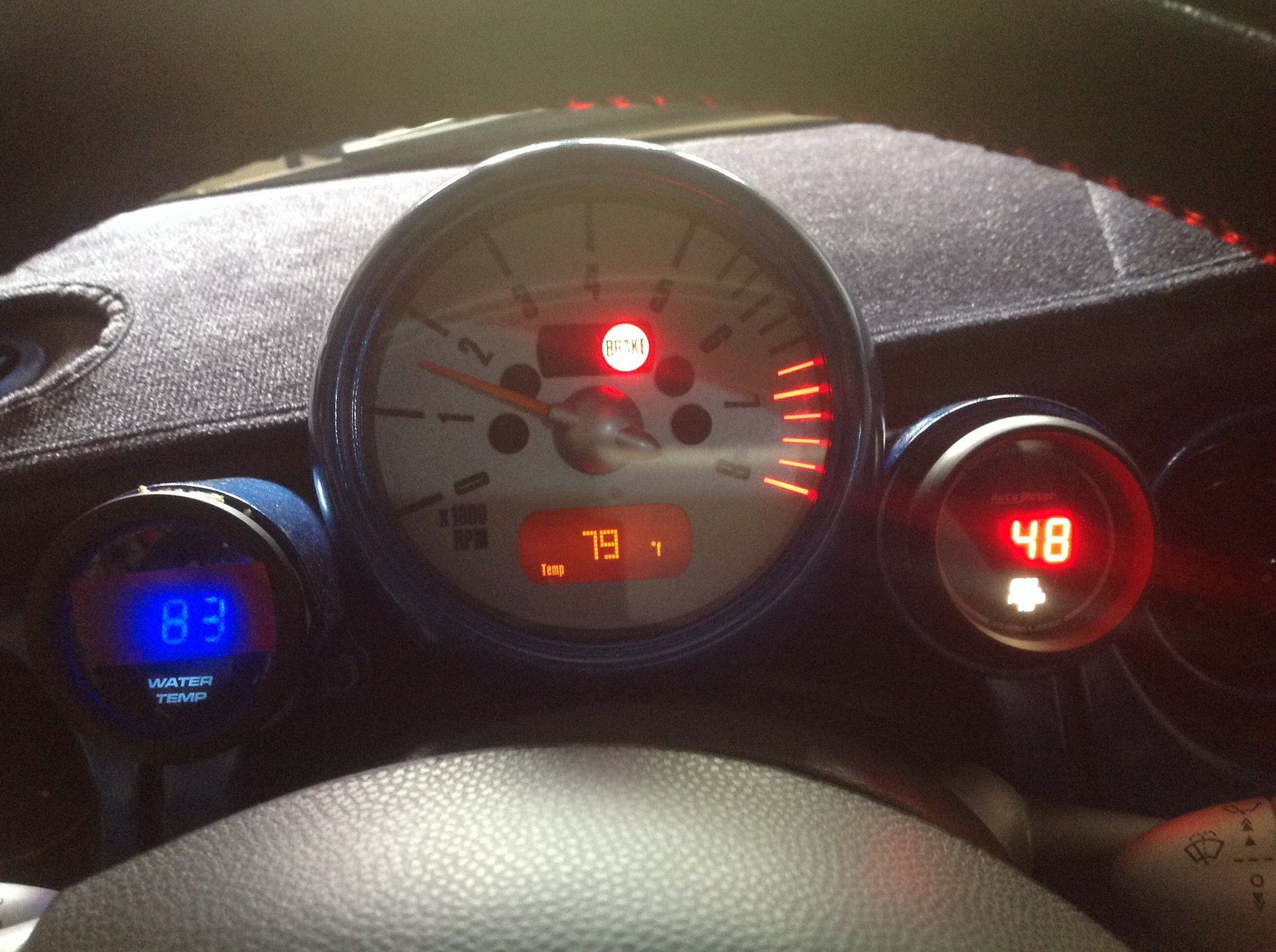

I had bothe the coolant temperature and oil pressure gauges, i recommend digital on both.

They are Auto Meter gauges - look close on the oil pressure.

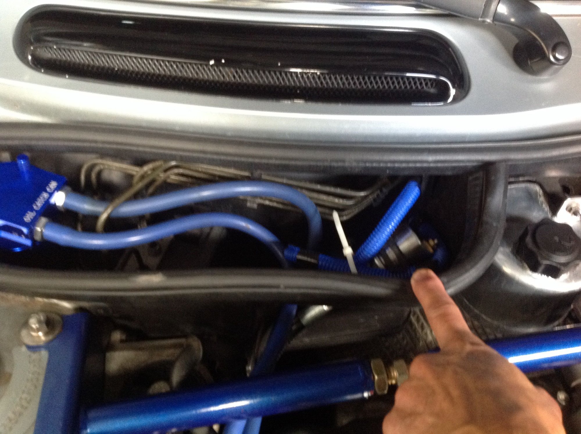

Yes the gauges are from Auto Meter some parts are from various vendors and installation i did it myself, tapping and soldering takes some times and its a challenge for DYI. The hard part is where you removed the oil pressure switch and then adding the adapter Tee for the gauge and the exhaust heat shields needs to trim it a little.

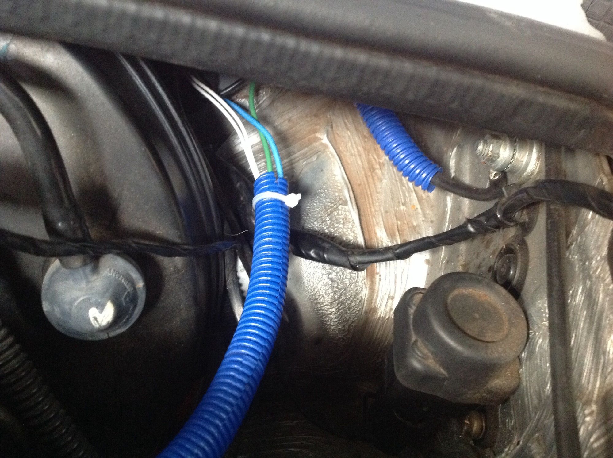

First picture where all the wiring goes and inside under the steering wheel, second is the coolant temperature sensor, and third is the oil pressure sender, i used hydra-air hose from the tee and away from the exhaust heat, accessible and convinient
