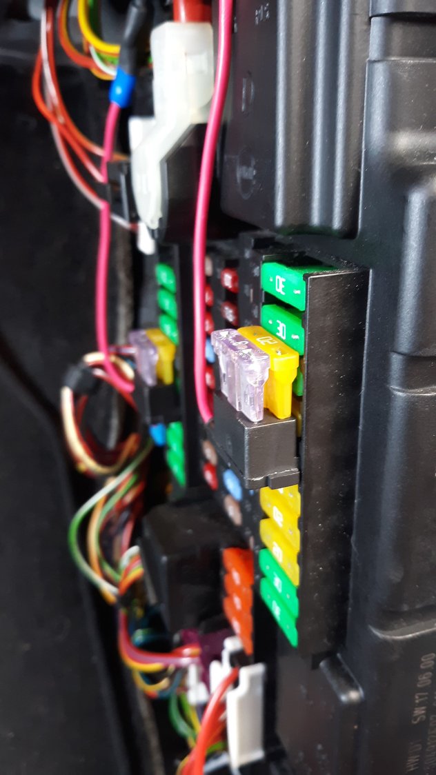

Hi folks.. I purchased a dashcam from Bytetronik in Tx. It's their R56 version, Looks super OEM, Very easy to install. Has an App you can download for both Android or Iphone to control. The camera comes with wiring that allows you to plug it's connector directly into your OBD2 port it you run the camera wires down the drivers side, or you can wire it down the passenger side and use an Add a Circuit fuse holder in the kickpanel on the passenger side.
The kit wires with Ground, Acc power, and constant power.. On my 2016 Countryman S, I wired the ACC wire to Fuse 44, then the Constant 12+ wire to Fuse 7. and the ground I wired to a large 13mm bolt on the passenger dash side. You see access to the bolt when you remove the glovebox.
