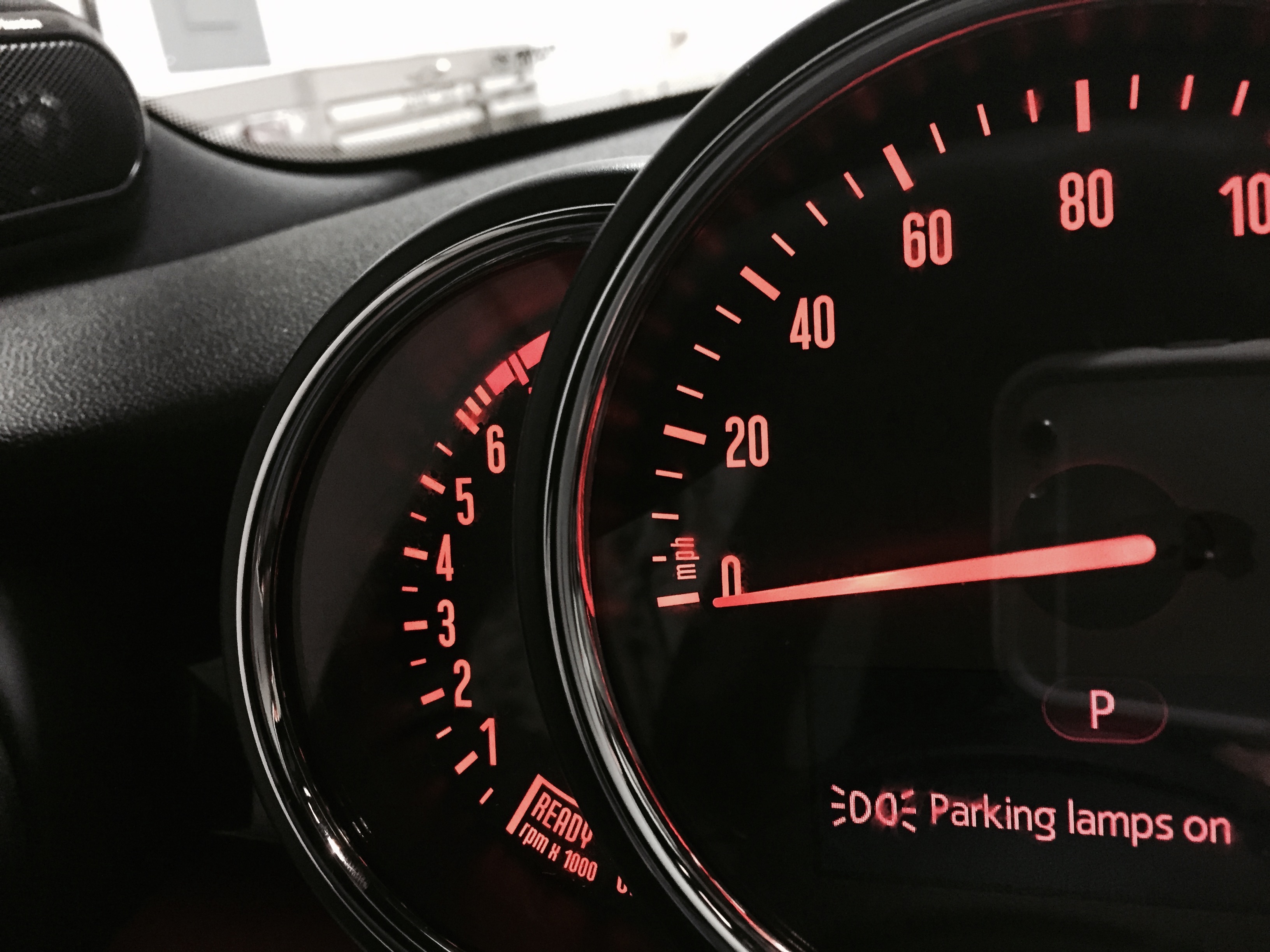

I just purchased a new 2015 2dr Hardtop. This car is stinking up my house. When the dealer was detailing at purchase, there was some condensation in the speedometer/tachometer. Car only had 9 miles on it but had been sitting on lot for 6 months. I was told the heat from sitting on lot caused it. I was to bring car back and they would take instruments apart and clean. I have yet to do this but my garage smells like mold. I've looked everywhere for wet areas, but nothing. Any ideas? Love the car. Such an upgrade over our 2013 model.

Moisture in the electronics? Was it a lot? Did you get a picture of it?

When the car was being cleaned, there was moisture behind the speedometer and tachometer glass. I was told to bring the car back at later date when service department would take it apart and clean the inside of the glass.

After 2 weeks at Mini dealer. Bulletin 64 02 14 was done. Told incorrect FIN GAP in evaporator allowing moisture to collect and bacteria to form. The Heater box was replaced and the automatic air conditioning evaporator was replaced.
The moisture in the speedometer and tach could not be repaired and the entire instrument cluster was replaced.
