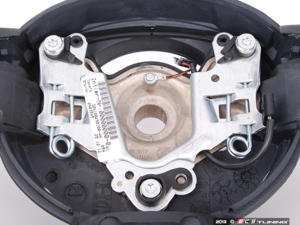

Check the wheel, most likely they did not place it to match the bottom tick mark on the spline.
Gen 1 R50 R52 R53
JCW Leather Alcantara Steering Wheel 32300403545
http://www.ecstuning.com/Search/SiteSearch/32300403545/
See the little mark> Should line up with the mark on the spline.
