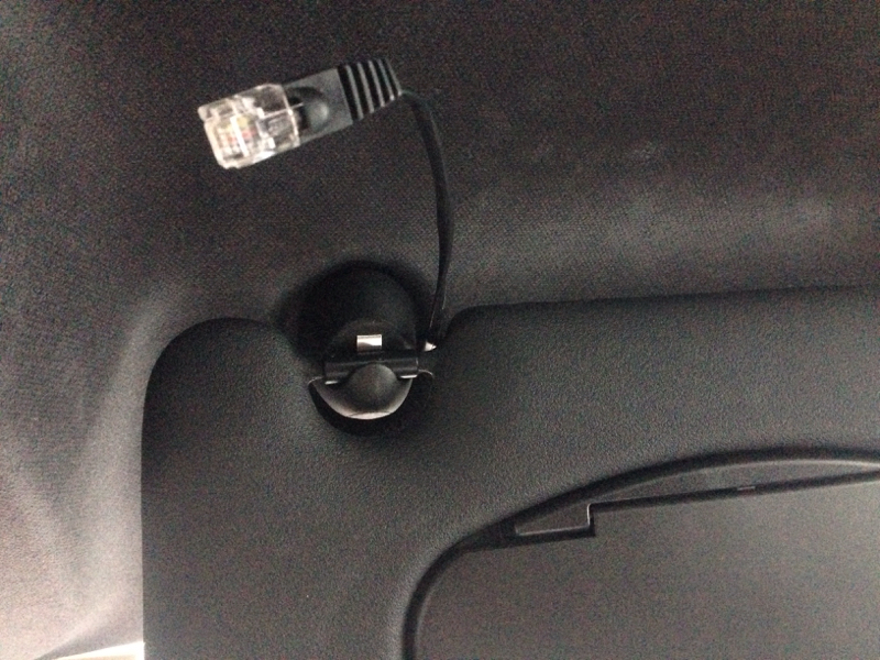

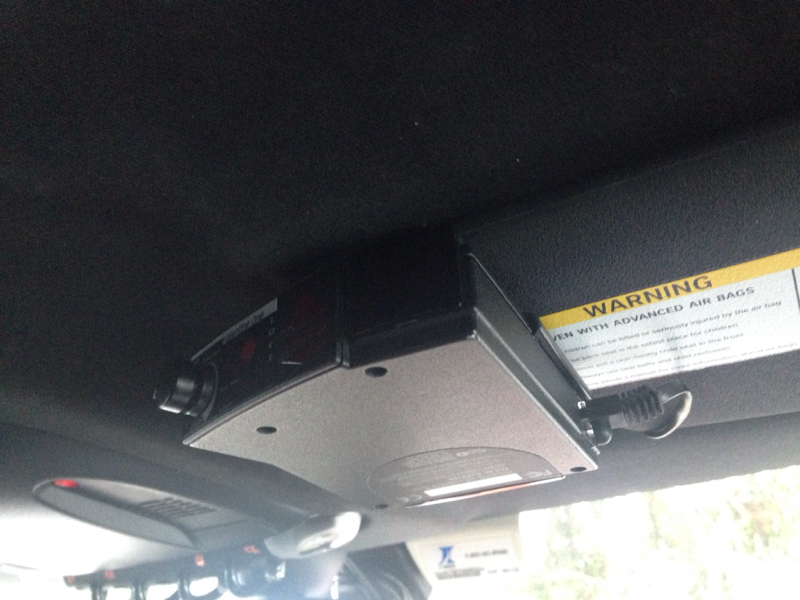

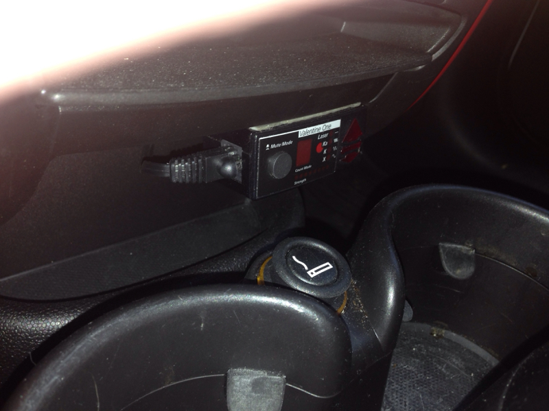

Not sure of the best placement, but I prefer to keep my V1 on the passenger side sunshade and off the windshield. It is far enough back that it is not visible from the street. I hid the cable by running it from the glove box, up behind the pillar, and above the headliner (accessed by removing the sunshade screws from part 3 below) I was able to have the wire simply falls out from the headliner where the sunshade is fastened. Instead of hard wiring it directly to the fuse box, I tapped a fuse and installed a dual 12V outlet in the glove box. I then plug into one of the outlets. I also ran a second wire from the glovebox to the center dash for the remote display. Overall, there are no wires visible.
