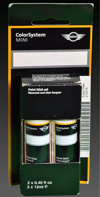

Hi fellow MINIacts and happy Friday!!!
Quick question. Is it me, or has anyone else noticed the paint on your MINI chips with minimal effort? I've noticed 2 chips on my hood and yesterday I just "very lightly" grazed the wall in our garage while opening the driver side door to get in and it chipped. Not much, but certainly enough to bother me because I know it's there. :(
Well, I ordered this product and was also wondering if anyone has ever used it. If so, any tips will be most humbly appreciated.

paint dings on MINIs and the "soft paint" discussion has been a hot topic since 3 weeks after the first MINI was sold in the US! One of the top 5 hot discussion topics which includes "15,000 old change interval, are they nuts", and "TOO MUCH BRAKE DUST" and "run flats suck" and "the windshield is soft because mine broke"
but I digress ....
first, you can not just apply a clear coat over the existing paint . . . I've painted cars, trained in a formal school and taught it .... Don't even THINK about it . . .
your car already HAS clear coat. All cars today are painted using a two part system ... a base coat of color and a top coat of clear (some have more parts .... my new FOCUS ST is 3 part ... color + pearl + clear) (the last car I know of that did NOT use base/clear was the first generation Miata in the non-metallic colors. In the late 90's a red Miata was STILL not clear coated - wanna know HOW I know - got one)
Is MINI clear soft? As one who buys clear from different makers / auto paint suppliers, I've never seen products rated for 'hardness' . . . does that mean it could be? or it is a non question ... IMO for hardness, clear is clear ...
The MINI has front end parts (and windshield) that are very vertical ... that increases the chance of dings
OP has ordered the factory touch-up paint kit. It contains a bottle of color (base) and a bottle of clear {that two part thing I was mentioning} This is just plain old touch up paint and is a good as any other although I usually get mine elsewhere (for less)
http://www.automotivetouchup.com/
{btw .. I WANT MINI PAINT! .... you have no idea who MINI is buying their paint from. In some years the paint for one color has 4 different matching formulas because that's how many times the builder changed suppliers and the shades CAN differ. You can not be sure the t/up paint in the bottle came from the same supplier as what's on your car. You CAN hope for a good color match and in 15 years of use, the link I posted has not disappointed me ....}
But the real KEY is not the paint, but the application .... and this requires skill and maybe some help. Search the detailing threads for touch up and you'll find long discussions
Here's a couple of quick points you may want to look into further
NEVER AND I MEAN NEVER try to fix a chip with the brush in the bottle. You WILL apply too much paint and end up with a BLOB. Some use super fine paint brushes (thin the paint), others use toothpicks and yet others use paper matches
There are products to help control the blobs.
http://www.drcolorchip.com/
http://www.langka.com/
I'm a Langka user myself ... but don't be fooled by either .... results improve with practice. Don't expect perfection the first time out.
There ARE plastic films you can apply to the front end to help protect things ... thick Saran Wrap! You can pay HUNDREDS to have it done at the dealer ... a bit less if you go to a vendor directly and you can buy the material yourself (see EASTWOOD.com) I've never been a fan of this however because IMO you ALWAYS see the seams/ends and the plastic gets dings that show too . . .

Hi Capt.
Thanks for this VERY informative post and valuable link. Unfortunately, I had already ordered the paint from MINI but will keep this link handy as their prices are most reasonable. My only dilemma is the process. It seems quite complicated and I'd be lying if I said I'm afraid to do it. I can try the small door chip since it's in an inconspicuous area, but the bonnet chips ... I really don't know about them. :(

and not to 'pile on' since you already see that this can be a wee bit more complicated than you first think. To fill a chip, and let's assume there is no dent - just the paint damage - you not only need to get the color in the right place but you need to match the existing surface level ... you want the result to be smooth.
This is what Langka helps with .. watch the videos .. start in an inconspic' spot and with L, if used properly you can START OVER . . . .

and not to 'pile on' since you already see that this can be a wee bit more complicated than you first think. To fill a chip, and let's assume there is no dent - just the paint damage - you not only need to get the color in the right place but you need to match the existing surface level ... you want the result to be smooth. This is what Langka helps with .. watch the videos .. start in an inconspic' spot and with L, if used properly you can START OVER . . . .
Thanks Capt. I'll keep everyone posted when my touch-up paint kit arrives from MINI (fingers crossed).
