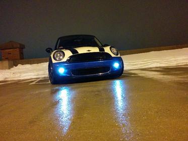

Here it is... Runs and drives great!
Attached Thumbnails 08 R56 Non S to  S Swap-forumrunner_20140112_110225.jpg   08 R56 Non S to  S Swap-forumrunner_20140112_110243.jpg

Why'd you swap bumpers? I thought I saw the white one on before.
White one was on before the swap but the non s front end does not have the ability to hold the intercooler for the s ... I'm sure with lots if modification you could but I have 20 hours on the clock for this swap so I was going more towards speed than ingenuity.
It will be painted white Lol
