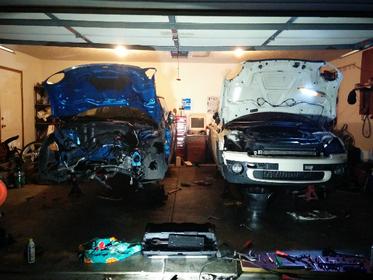

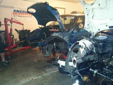

I have the part car.
Did the direct motor/ecu swap
Swapped the battery / fuel pump
The swap was fast and easy.. took less than 12 hours to take both out and put the s in with fuse box and DME
HOWEVER
The car will crank but will not fire...
Would anyone know the problem or has done this swap before.
I have the CAS out and ready to swap but i don't want to pull my car apart more if i dont have to... essentially getting fuel but no spark and all the wiring checks out.
I know many have said its useless to do this swap but the motor on my non s blew and I found a salvaged S that ran but had severe chassis damage for under 5k including shipping.
Any help will be appreciated.

Pics of the swap
Attached Thumbnails 08 R56 Non S to  S Swap-forumrunner_20140105_211549.jpg   08 R56 Non S to  S Swap-forumrunner_20140105_211603.jpg   08 R56 Non S to  S Swap-forumrunner_20140105_211645.jpg
