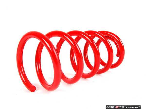

+1 for JCW springs and JCW suspension.
http://www.ecstuning.com/Search/33500429708/ES58067/
You get the shocks package above:
And the JCW Springs are ordered to options on your MINI, you will have to have your VIN and the options.
The JCW springs really look good.
