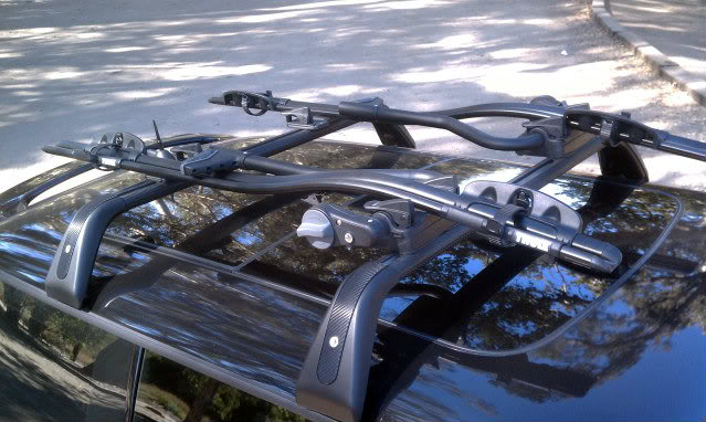

Another option...factory rack with Thule Criterium trays. This rack set up allows me to keep the front wheel on the bike and enough adjustability to carry kid bikes when occasion arises.
