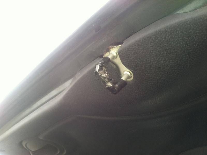

I forget who on this forum told me, so I can't properly credit this advice. Wrapping the part of the catch on the bootlid itself with electrical tape will stop the issue. You have to use just the right amount, so it doesn't interfere with latch operation, but still keeps the lid from moving around. It really works, and the member who clued me in said he learned it from his dealer. He also said it may need to be redone periodically, but I have over 10k since I first did it, and it's fine. Other noises have popped up since, though.....

Because I know firsthand how annoying this is, and because my explanation may have been lacking, I've taken a photo of the area that needs to be taped. As far as how much, I forget, but it was probably two or three turns. Mine looks like heck, but it's been on there for almost a year now. Still quiet, so I don't feel the need to redo it, but could if I was more picky. So anyway, this is part of the latch, on the bottom center of the trunk lid that holds it closed.

PROBLEM SOLVED, this is WHY I joined the forums because of people like you! Between the mutual understanding of the problem, fast clear cut responses and pictures to clarify exactly where to fix the annoyance I am now a happy man. thank you so much and I hope there are other people out there that read this thread and tackle the same issue. Once again brother THANK YOU and if there are any other little tips you may introduce me to let me know.
