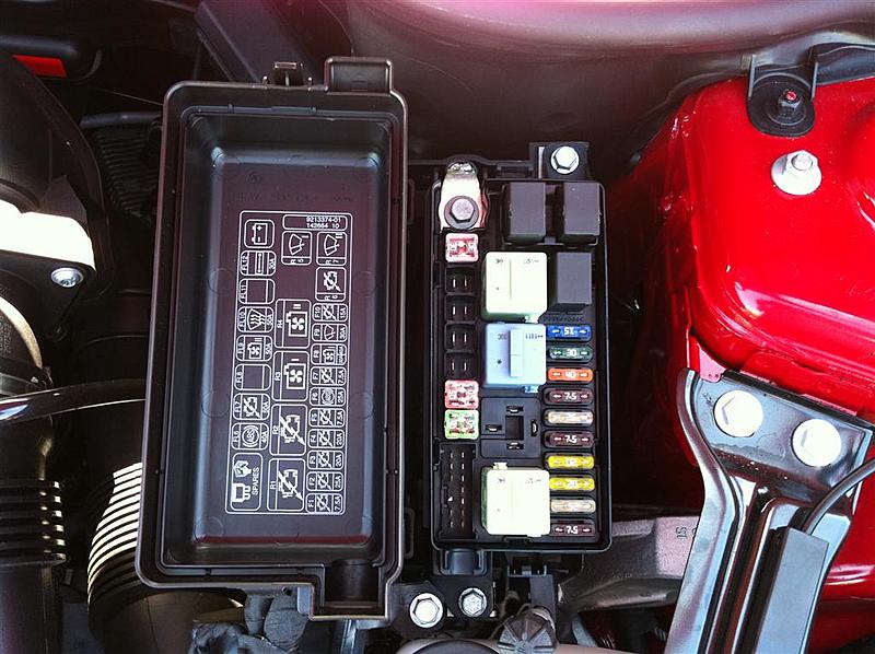

Supposedly the tint guy pulled the positive terminal and was also in the engine bay fuse box pulling fuses to get the windows from going up/down the 1/4" when you close the door. Ugh....
None the less now my a/c is not cooling and only blowing hot air. I cannot feel the compressor kicking in. The snowflake light is on and I have the a/c set to low. I put a fluke meter across each fuse in the engine bay and the passenger side fuse box and all fuses are good.
Here is a pic of the engine bay fuse box. I realize that some of the fuses missing may be intentional due to specific options, but if someone sees something amiss please let me know.

I have a 2010 S, but not a JCW. I just checked my fuse box and it looks like maybe your 50amp fuse is in the wrong spot, plus maybe a missing relay. I guess it does depend on the equipment though. My S is pretty loaded electrically. NAV, PDC, DTC, H/K, alarm, auto a/c, Sat radio, no sunroof though. The 50amp fuse is for the radiator fan or condensor fan. It's one in the same since there is only one.

Before I saw your post I called my mini sales mgr and he looked at the fuse box of a jcw on the lot. The red 50A fuse was in the left side was in the wrong spot as your pic pointed out. However the big green relay looking fuse in the center was missing on his jcw as well. Thanks for taking the time to reply so quickly!!!

Tell him next mini to just leave the door open and us a screwdriver to close the latch in the door. This makes the window pop up and stay up.
I think you are missing a relay too. The condenser fan it looks like which is AC related.

Checking fuses
Hey device manager,
Hopefully you have your problem fixed already. But if not, I know when checking aircraft fuses/current limiters, you have to isolate the piece you want to test by disconnecting one end. Otherwise the Fluke will read the entire circuit as continuous and give you a false reading.

@MINIDean, yes once I moved the red 50A fuse on the left up two spots to FL9 the radiator fan kicked on and the a/c started cooling.
As far as the green relay looking fuse in the R2 location it appears that may be for the cold weather package which I do not have.
