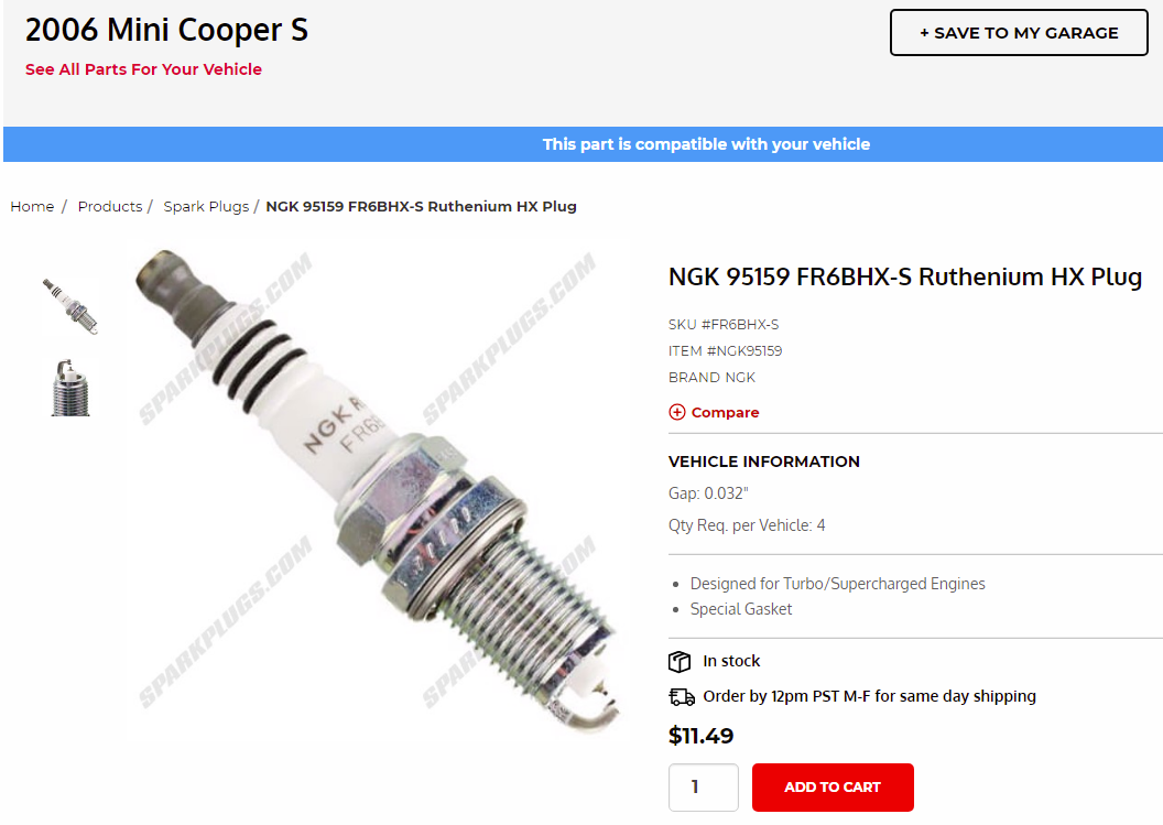

Mine is an '06 R53.
ngk.com is a little wonky in that department...
...what I did is find the one that they "verify" and just go 1 heat range colder:

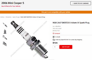

Like,
if I type in the plugs I've been using lately which have been doing really good,
and thoroughly documented by many others as good ones too,
are these which NGK tells me are incompatible:

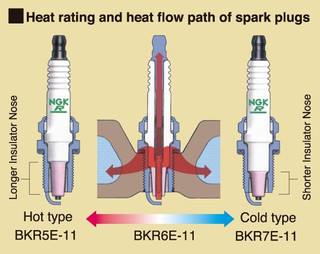

But they are kosher!
NGK will list the BKR6EIX as compatible,
but not the 7.
Rather odd,
but I guess it's a liability thing on their end where the legal department requires them to strictly adhere to OE spec?

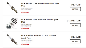

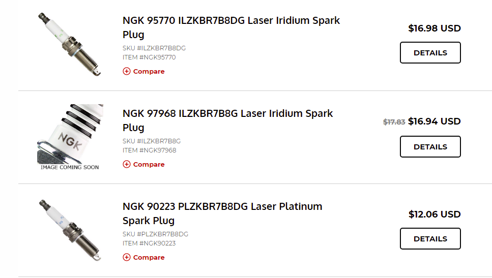

Originally Posted by bisnitch
Yeah, I have an 2007-2011 r56 so here is what the NGK Part search tool was showing but it wasn't clear about the turbo or DOHC option.
That chart indicates only for the R50/52/53 with the W10 or W11 motors...
...punched in 2010 MCS to see what they list,
all they have are three available options,
and one of those is discontinued!
Tried to do a cross reference based on that but couldn't find anything.
Gave a quick look into other cars that use the Prince engine that may happen to have alternates that people have found,
still didn't find much...
...but I kinda dig the DS3 -
May be best just to write or call NGK and ask them.

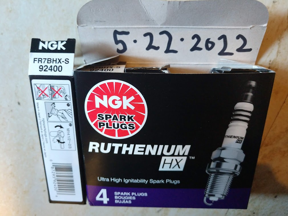

OBS... Did you ever run the FR7BHX-S Plugs, on the R53?

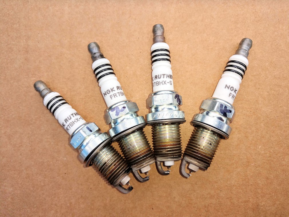

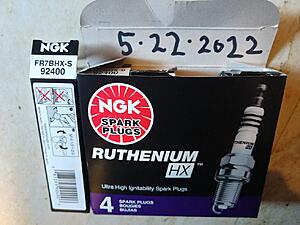

I did indeed, put them in several months back.
They've been performing very well!
Will inspect them soon and see how they look after 4 months.

Thanks for that OBS 👍
I was surprised by the price … only about $8.50 each on them from reputable distributor…
I think that’s what I’m going to run on the stock 2006 JCW … seems like a more durable alternative and may have some other benefits

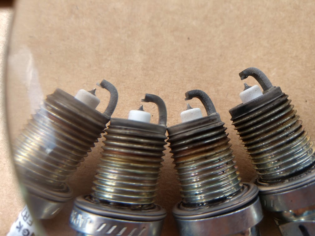

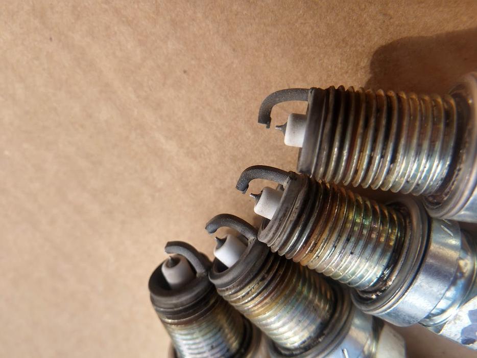

Did oil change today and pulled plugs to check them, can't really say much except that they've been performing well and appear A-OK after inspection and I think that the protruded tip is a great design.
Gapped at 0.29" and they're still there.
I haven't experimented much with various gap sizes,
but wondering if I should?
Any input/opinions regarding gap size is most welcomed!
Thanks.
A couple of pics:

OBS, thank you !!.. Those look to be great... I didn't see your reply above with pics...
