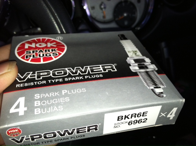

So I thought I would like copper plugs rather than platinum, because they conduct electricity better, and dissipate heat better; and I don't mind having to change them more often.
I picked up some NGR BKR6E yesturday. The guy at the parts store said they were copper. Come to find out, though they have copper in them, the electrode and ground prong are nickel, which is worse than platinum.
Does anyone make a plug that has a copper electrode and ground prong?
I looked at a website for Brisk and another one (Nolog... Er something like that). -I'm not finding much specifics, and ideally I hope for something that I can find in an import parts store.
Anyone ever tried the v-power ngk's that I got? For the $8 I paid for the set, and their heat range of 6 I'm thinking it couldn't hurt to try them, unless anyone has had a bad experience with them.
I also found a champion plug which has a copper/nickel electrode and ground. I could probably return/exchange the NGk's I got for the Champion. The Champion has a different number for the heat range, but I think it's just that champion has a different scale than how ngk rates them.
I won't install any till its cold-cold on a morning I have free, probably Monday.
Looking for anyone with experience with above two plugs, or a suggestion if you know of a plug with copper. The other ones I mentioned look to both be silver, I bet expensive, and probably not available at my local parts store.
Thanks in advance for your thoughts.

Maybe because of the plug you are using and possibly from your gaps not being equal. I don't understand what you are trying to gain by not using a quality plug. Ok great copper conducts electricity better. But you gain nothing by using them and replacing them more often means more risks of ruining the threads in the head from constantly changing them.
Just get the NGK 3199 4 prong plug. No gapping needed and torque them down to 22ftlbs and forget about them for 25-30k miles.

Copper plugs are VERY short lived.....think ONE oil change.
In a stock MINI S, stock plugs should get you about 90,000 MILES.....if you run a pulley, more like one service (going with the JCW plug recommendations, both life and type)..so 30,000 miles!!
With the threads in a MINI head being so soft, I suggest getting Iridium plugs....maybe Platinum....which sometimes has has issues in turbo.SC motors...but the manfactures engineers have engineered their plugs to be OK.
The info you have in the tables...in a perfect world IF YOU were BUILDING a plug might be useful...then an engineer does some calculations..some design work..some testing....and they ALL WORK THE SAME!!!
Ever wonder WHY the tips on different types of plugs are different....same if you ever saw cutaways of plugs...to matain the life, and temp range, they are all different.
That is why I suggest just going with NGK, a company that KNOWS plugs, and does MORE OEM ones than most companies...and IS THE OEM BMW/MINI plug.
Just get the OEM or the equivalent....so spend $10-12 per plug...and no worries!!
The iridium plugs CANNOT be gapped.....same for the OEM style OEM multi prong plug.
