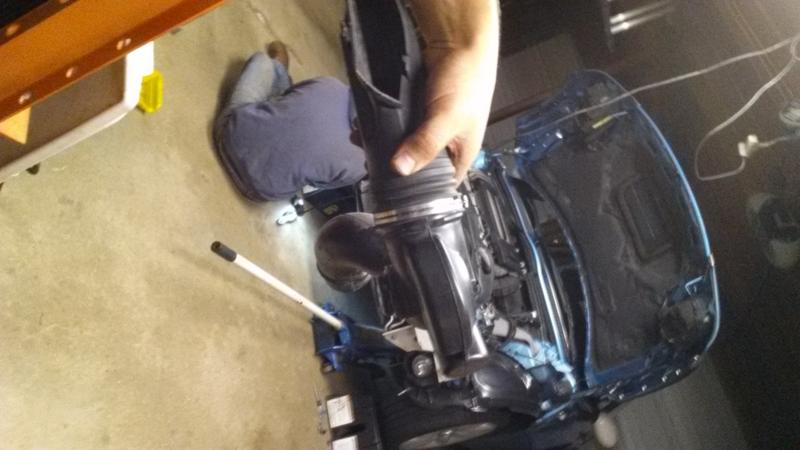

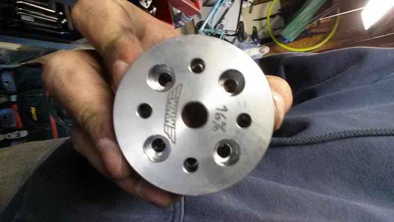

installed a 16% pulley from WCW,cabin air, oil, and de-baffled the snorkle, just to clean it up. Did the de-baffling help anything? No. Did it take 10 seconds to complete and make me happy? Yes.

What's the de baffle do?

According to the LS1 forums (LS1 also has a baffle on its snorke), it's supposed to damper the intake sound by creating a chamber to resonate any intake droning. But I have an intake (PROMINI ) that pulls air from the bay as well as the snorkle, so the baffle is unnecessary. And who doesn't like the intake sound?

Interesting, sound any different?

I also installed a 16% pulley, so the lovely whine kind of takes over the sound in the front. From a stop, a hard takeoff you hear that deep "voomp" maybe a little better? Nothing to run and go mod immediately, but I guess if you have the snorkle off and some 5 minute epoxy lying around like I did, it may be worth it. All I did was cutthe baffle off, then cut off the end piece of the baffle with a hack saw and epoxied the end cap back to the base of the baffle on the snorkle, effectively shorting the baffle from approx. 6" to maybe 1/4".

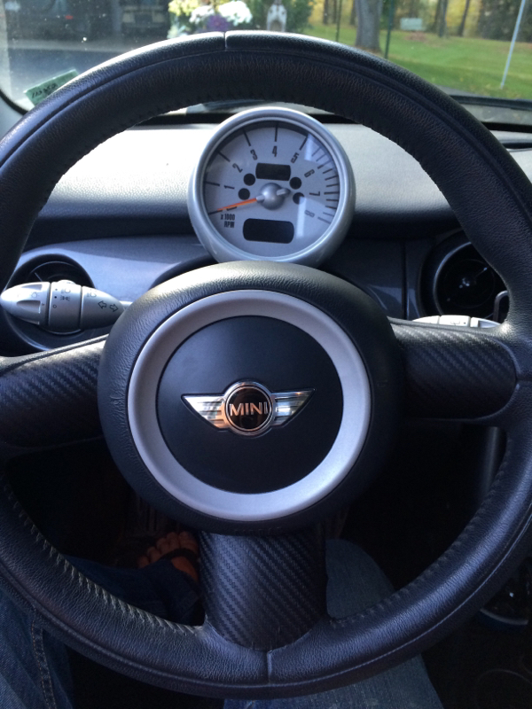

Carbon fiber wrapped my steering wheel trim, came out decent but I have to hit it with the heat gun yet.

I forget which member that has a real carbon fiber made steering wheel, it's pure carbon ****!

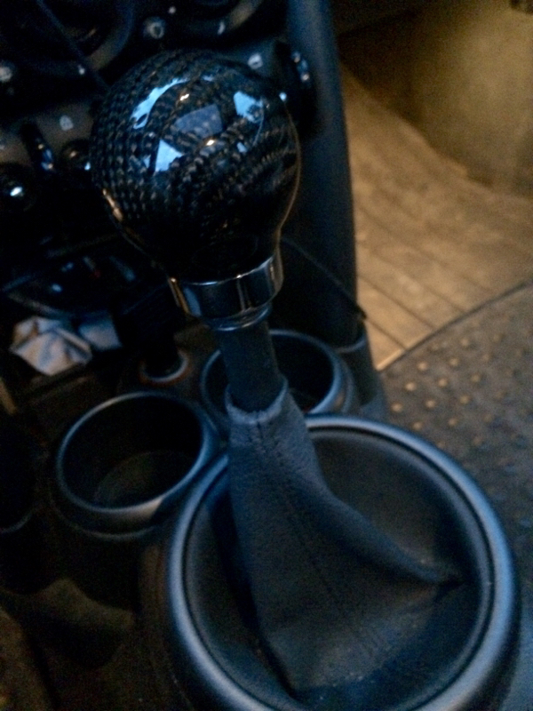

If it wasn't such a hassle to remove the trim I'd get at least real carbon trim to match my shift ****
