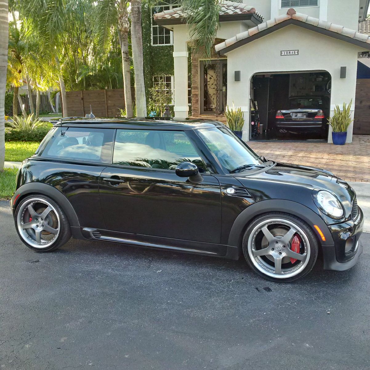

Thanks for the replies. I ordered a set (front/rear) from R1 Concepts. I'll provide some updates in a few weeks.
