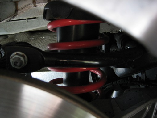

My understanding is that the JCW suspension also has different struts which lower the car, and larger sway bars front and rear. Attached is a photo of the JCW suspension installed with a good look at the larger rear sway bar.
Ronnie948, is your car with the factory sport suspension lower than a car with a stock suspension? Can you upload a photo of the wheel well gap?
Attached Thumbnails how will i know if i have sport susp or not?-suspension_rear.jpg
