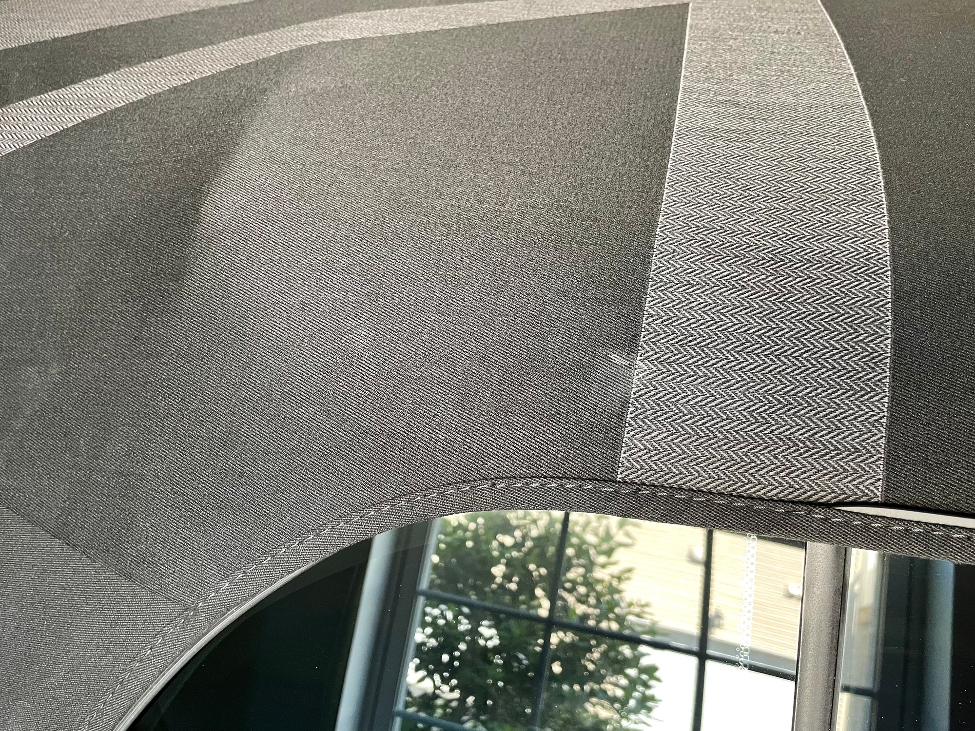

I have something similar with my car (also a 2019), on the passenger's side. I've identified that this particular spot, where the fabric is actually wearing away, is from the top rubbing on itself when folded. My car is still under the bumper-to-bumper warranty until May 2022, so I plan to take it to the dealer in very early spring to have it addressed before the warranty runs out. I know of someone else with a 2019 that had similar issues, and the top on her car was just replaced by MINI.
Here's a pic of the problem spot on my car. It's kept in a garage full-time, only driven in nice weather (only occasionally caught in the rain), and I always hand wash and never with a pressure washer. I've also cleaned and treated the roof once a year with approved products. It may be hard to tell in the pic, but the other black fabric has worn away in this spot, exposing the silver-colored layer that makes up the Union Jack logo on the roof.

BTW, my wear spots are identical to yours.

i determined the problem. there are seams/folds of top material beneath both corners of the back window. when the top is lowered it rests right on those seams. the rough surface of the top apparently rubs on itself when hitting bumps, etc., causing the damage. in my case the damage is more severe on the passenger side, which presses much more heavily on the seam than the left side. how this isnt a design or manufacturing problem beats me. seems like if BMW/Mini never really looks at it it will never be a real problem to them.

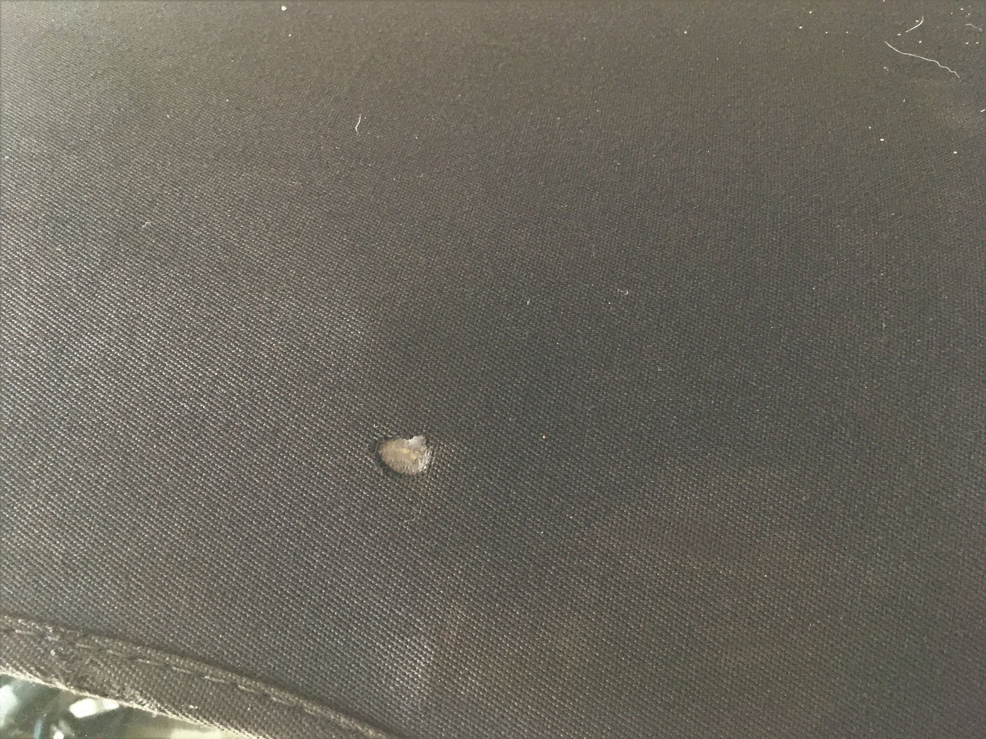

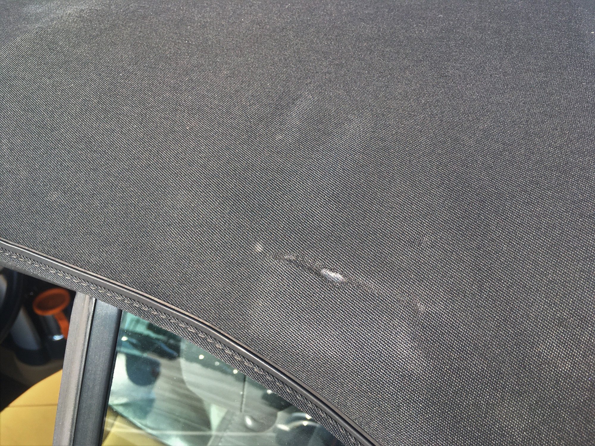

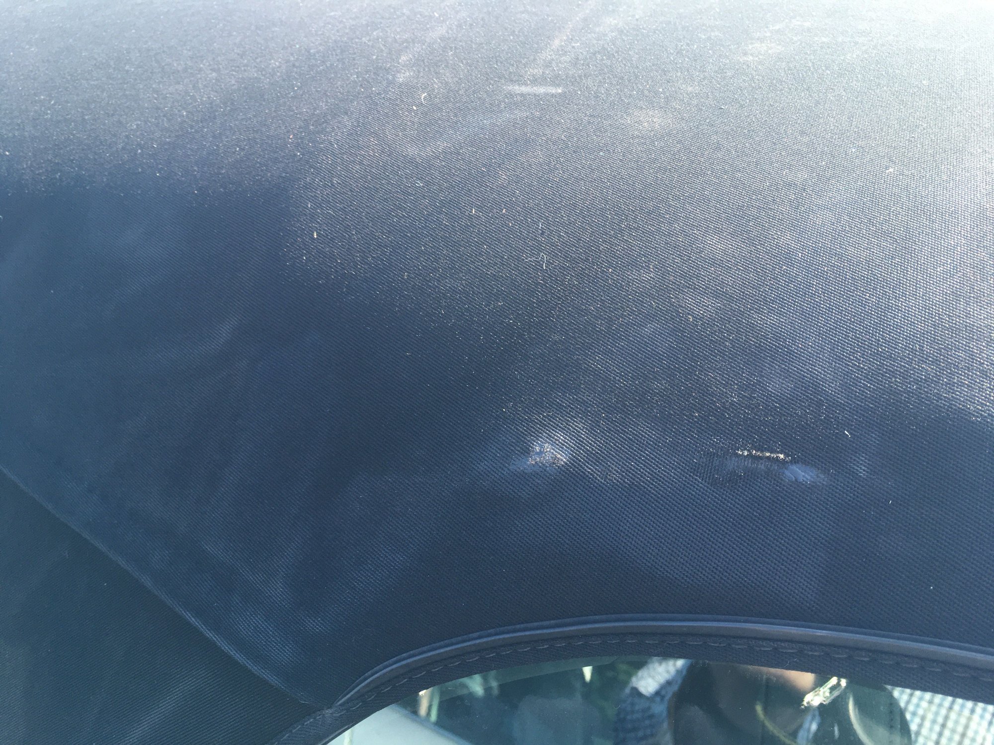

I dont have good news. Honestly, I think its just part of living with a convertible. I have an R53 and an R57 and both have the same wear locations on the roof after an average of 12 years and 170k miles each, but fortunately neither seems to ever lets in any water. Once its out of warranty just enjoy driving it as nature intended. The rubber membrane lining in the older one is flaking off, but its still dry as a bone. Touch wood I haven't just jinxed it
R53 180k mile roof wear port side
R53 roof wear starboard side
R57 160k roof wear port side
R57 roof wear starboard side

Yep. My independent top repair person said he sees more vert tops with rear window issues than anything else but every Mini he has ever seen has the same marks. His advice, too, was enjoy it. He has never seen one wear through completely. His comments helped me decide to keep mine - which still looks and rides like new despite 80k miles. New (non run flat) tires coming this week!!! Happy Motoring.😄
