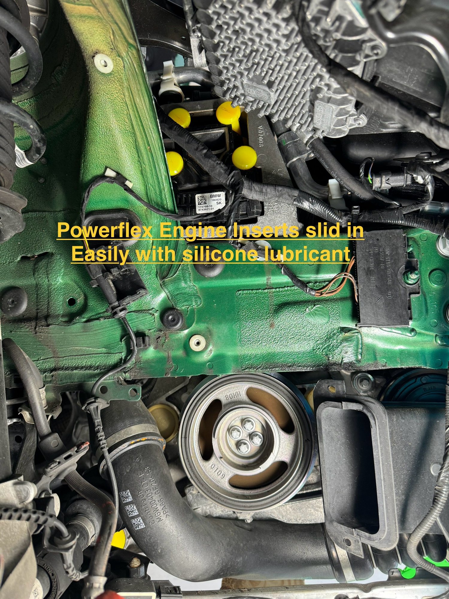

FYI you can easily insert the PowerFlex Upper Engine Mount inserts into a F56 S Mini Cooper while the upper engine mount is still bolted in place.
Mine is a 2021 Mini Cooper S.
My vehicle only has about 15,000 miles on it, so I think the upper engine mount still has plenty of useful life in it, but I decided to install the PowerFlex Upper Engine Mount inserts to potentially extend its useful life and maybe prevent the mount from failing, but time will tell.

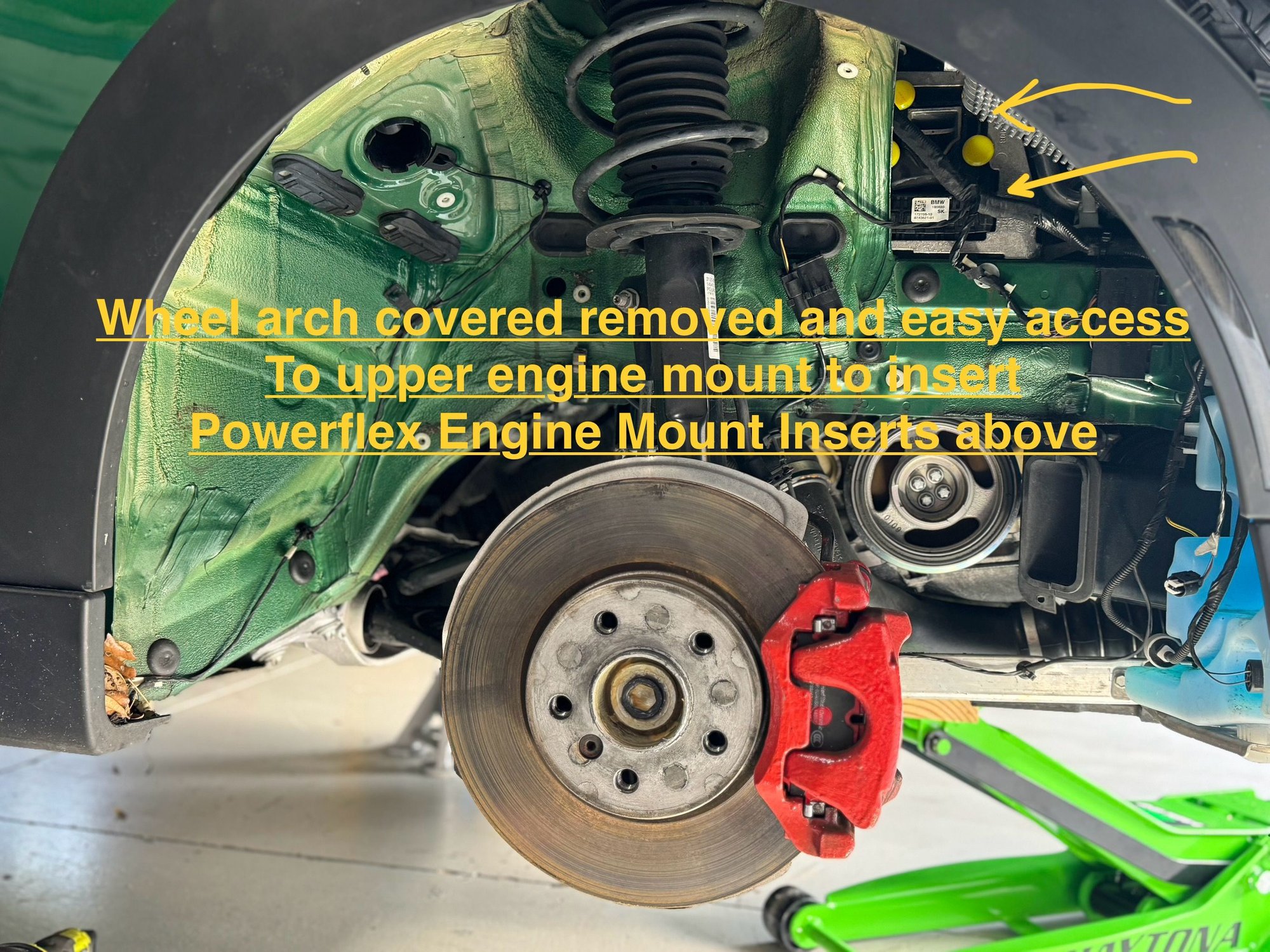

Instead of removing the right side headlight, you can gain easy access to the upper engine mount by removing the right front wheel arch cover (easier with the wheel removed and the car on jack stands).
With the upper engine mount now accessible, you can then slide the PowerFlex inserts into place with the help of silicone lubricant.
Reinstall the wheel arch cover, and you are done. The process took less than an hour.
I did not notice any new vibrations with the PowerFlex inserts in place, and time will tell if they prolong the life of the upper engine mount.

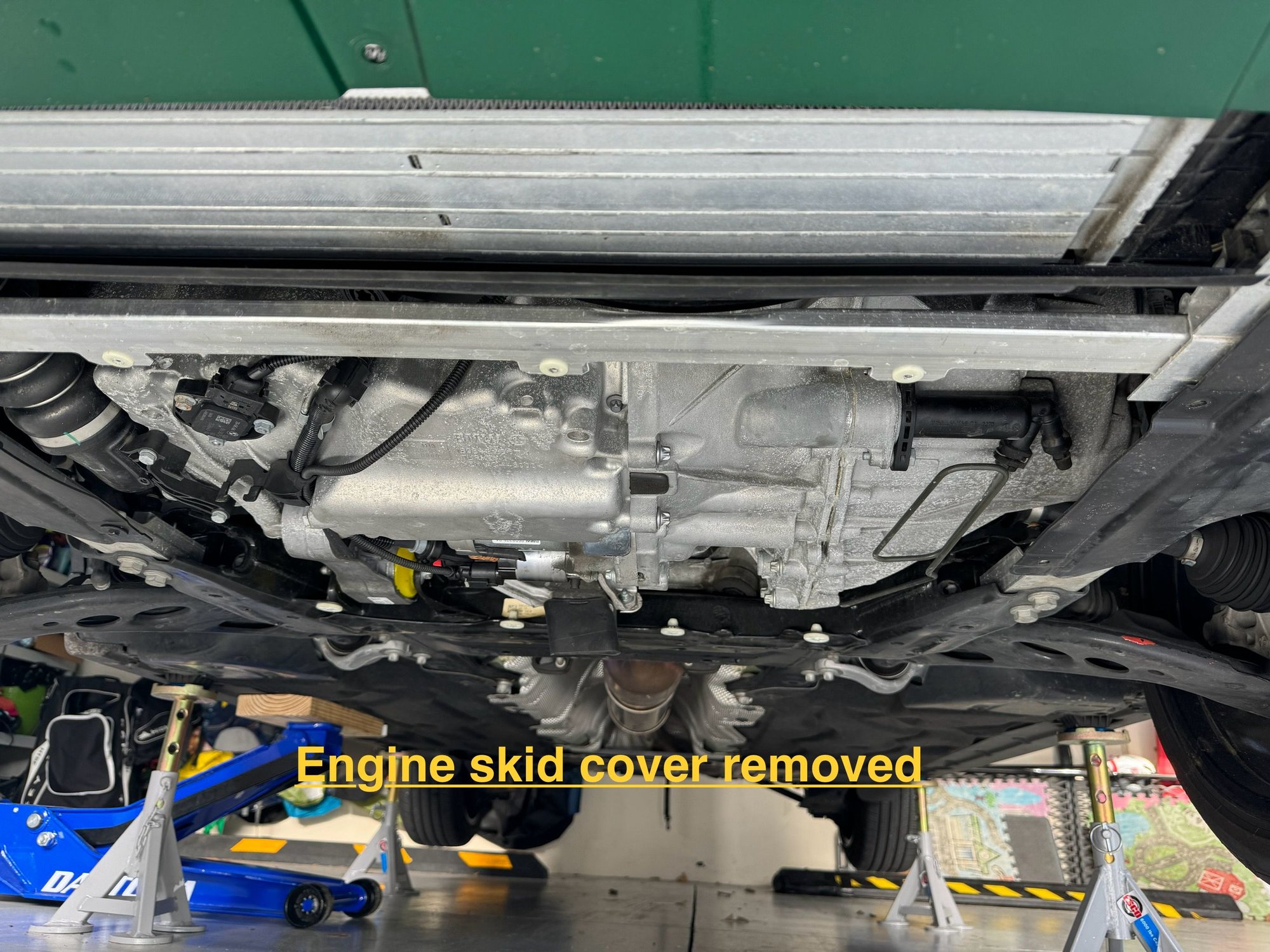

With the MINI safely on jack stands, remove the engine skid cover via about a dozen 8mm screws

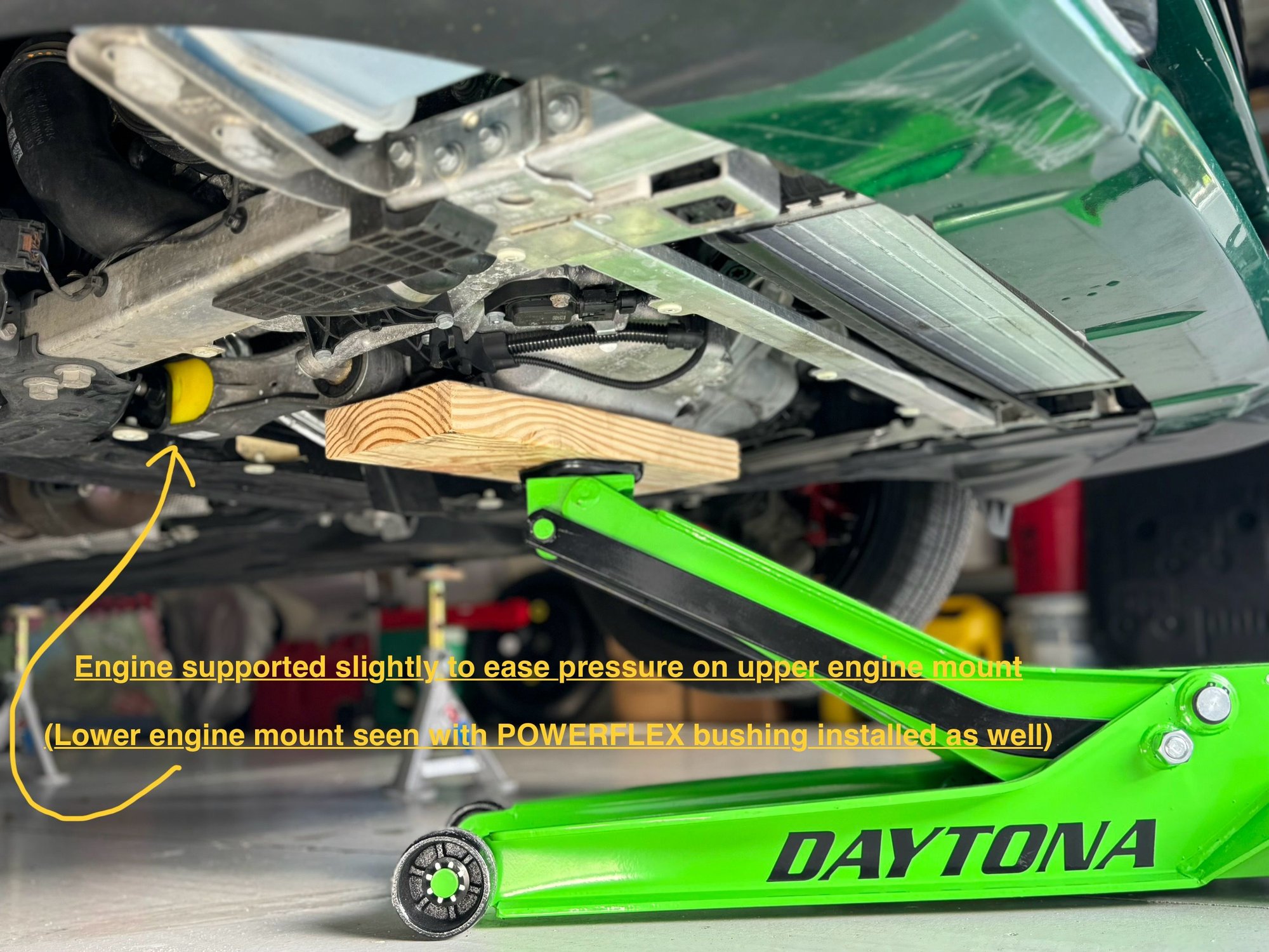

Support the bottom of engine and lift it slightly about 1/2”. I installed the PowerFlex Lower Engine Mount bushing last week as seen in the photo.
Remove the right side passenger wheel arch cover via about a dozen 8mm screws and about 4 push pin connectors. Some screws are on the bottom of the vehicle trim.
The upper engine mount is accessible with wheel arch cover removed.
Lots of silicone lubricant helps to ease the Powerflex inserts into place.
Final product prior to reinstalling wheel arch cover. Entire process took less than an hour.

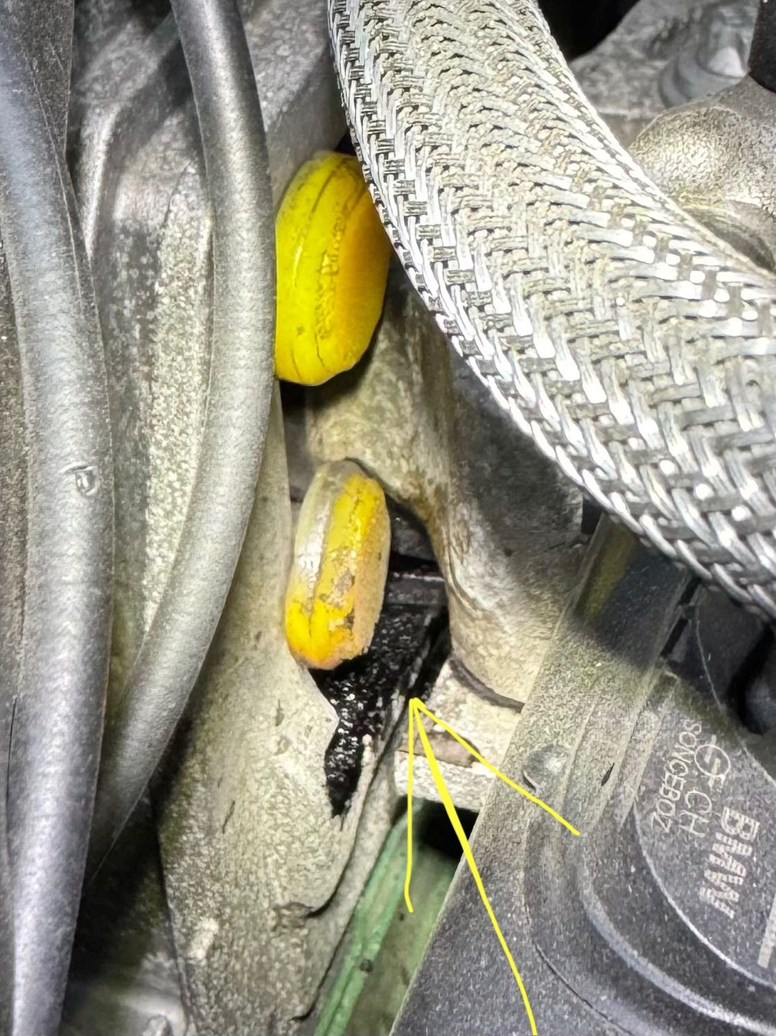

UPDATE: upper engine mount still failed at 30,000 miles
***** UPDATE:
My upper engine mount just failed at 30,000 miles despite inserting the PowerFlex inserts at 15,000 miles as noted at the beginning of this thread (Installed PowerFlex inserts 19 months ago):
I attached pictures that show the black fluid oozing from both side sides of the bottom of the engine mount. There are no symptoms while driving the car such as vibrations or clunking, but I’m sure that is soon to follow.
I just ordered the GP3 upper engine mount with new mounting bolts and the 3 headlight adjustment screws, and I will install them once I receive them. I will reinstall the power flex inserts and hopefully get more than 30,000 miles on the new mount!
