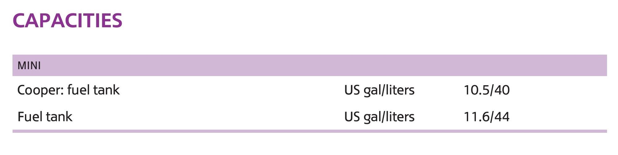

Yes, I can see why the capacity was discussed to death. On the 1.5L 3 cylinder, there are several numbers out there, 40L, 44L or 50L, and then you throw in two kinds of gallons and you get a big mess.
Is there any consensus? My 3-cylinder car is from August 2014, made for Canada. Everything I have from that time (PDF manual, spec sheet) suggests 40L. The PDF manual is a bit confusing.
The physical manual only has one number, 44L, so that's probably correct for Canada at that time,

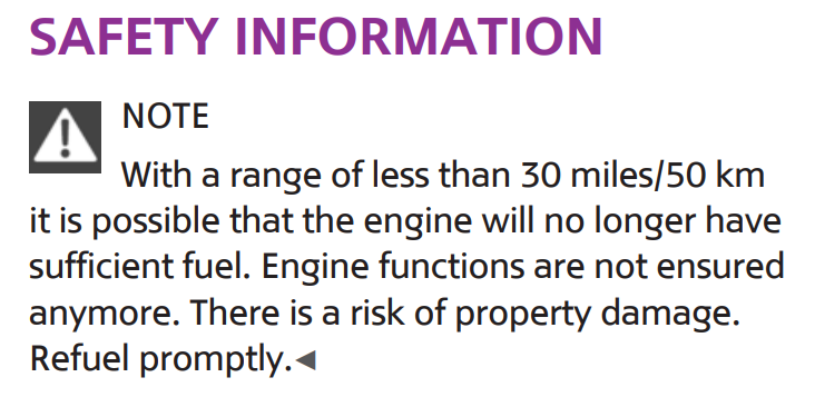

The Fuel Reserve warning showed up just before I made it home tonight. It showed at 10.4%, and just a few seconds later it dipped to 10.3%.
The app tries to calculate the range and was at 52kms, so maybe it's when the car calculates 50kms. What does it say in the manual...the message shows continuously when the range is below 50kms.
Old Apr 17, 2024 | 06:18 AM
cjv2's Avatar
cjv2
Joined: Aug 2017
Posts: 1,056
Likes: 384
I haven't seen anything in the manual that specifies when the fuel reserve warning will kick on.
However, it does have this, which intriguingly correlates with your 50km hypothesis.
