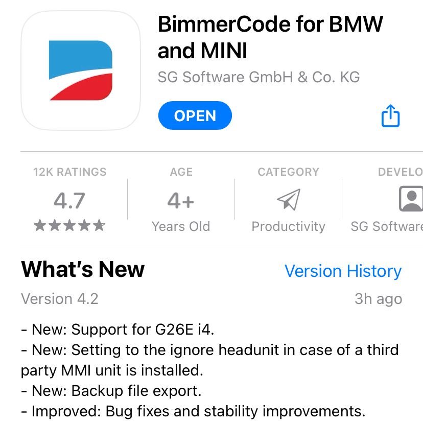

Side Note: BimmerCode was updated today with some new features, fixes and stability improvements. It’s hard to believe the last update was over a year ago

ooooo. Backup export. If it’s readable, YAY.

Well, the backup is not readable so that takes care of that question
