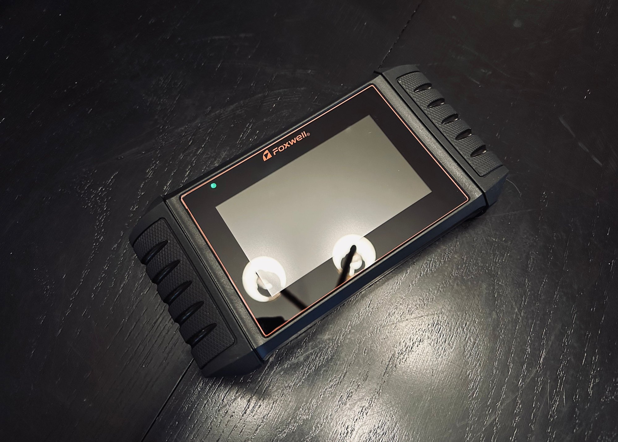

After a long transit time the unit arrived and here’s my first thoughts and quick review
: Build Quality :
- Overall the unit is very solid and easy to hold
- Love the rubber handle grips on the ends
- Display is bright and text is easy to read

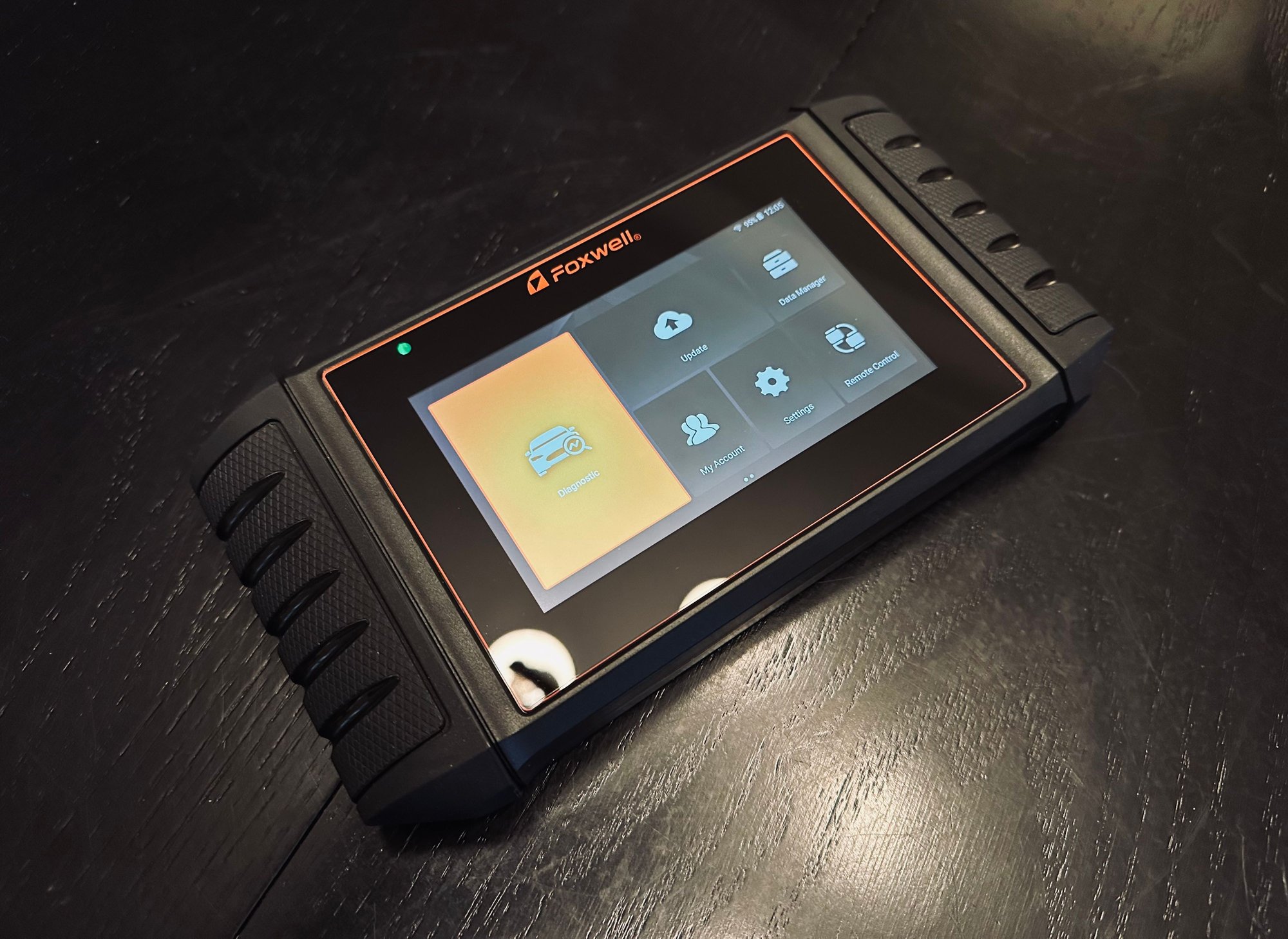

: Software :
- Android based OS and straightforward
- Foxwell’s software was simple to navigate through and they made updates easy to perform
- Registration took under two minutes
