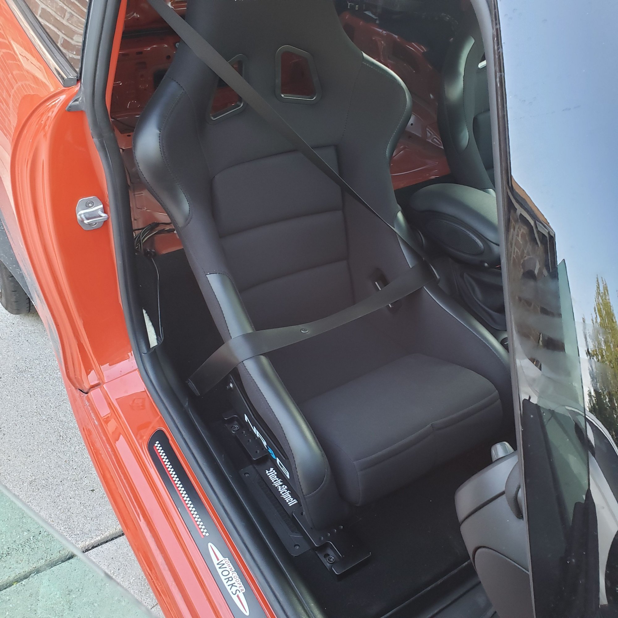

Got my mounting plates from Macht Schnell today...looks like they will work perfectly...looks like the two seats will save 44 pounds after mounting! The Mini should weight in at 2676 compared to when I bout it at 2875 so 199 pnds out of the Mini so far...
Old Apr 27, 2022 | 05:51 AM
Darbys2019MiniJCW's Avatar
Darbys2019MiniJCW
Joined: Apr 2019
Posts: 401
Likes: 243
From: New Braunfels, Texas

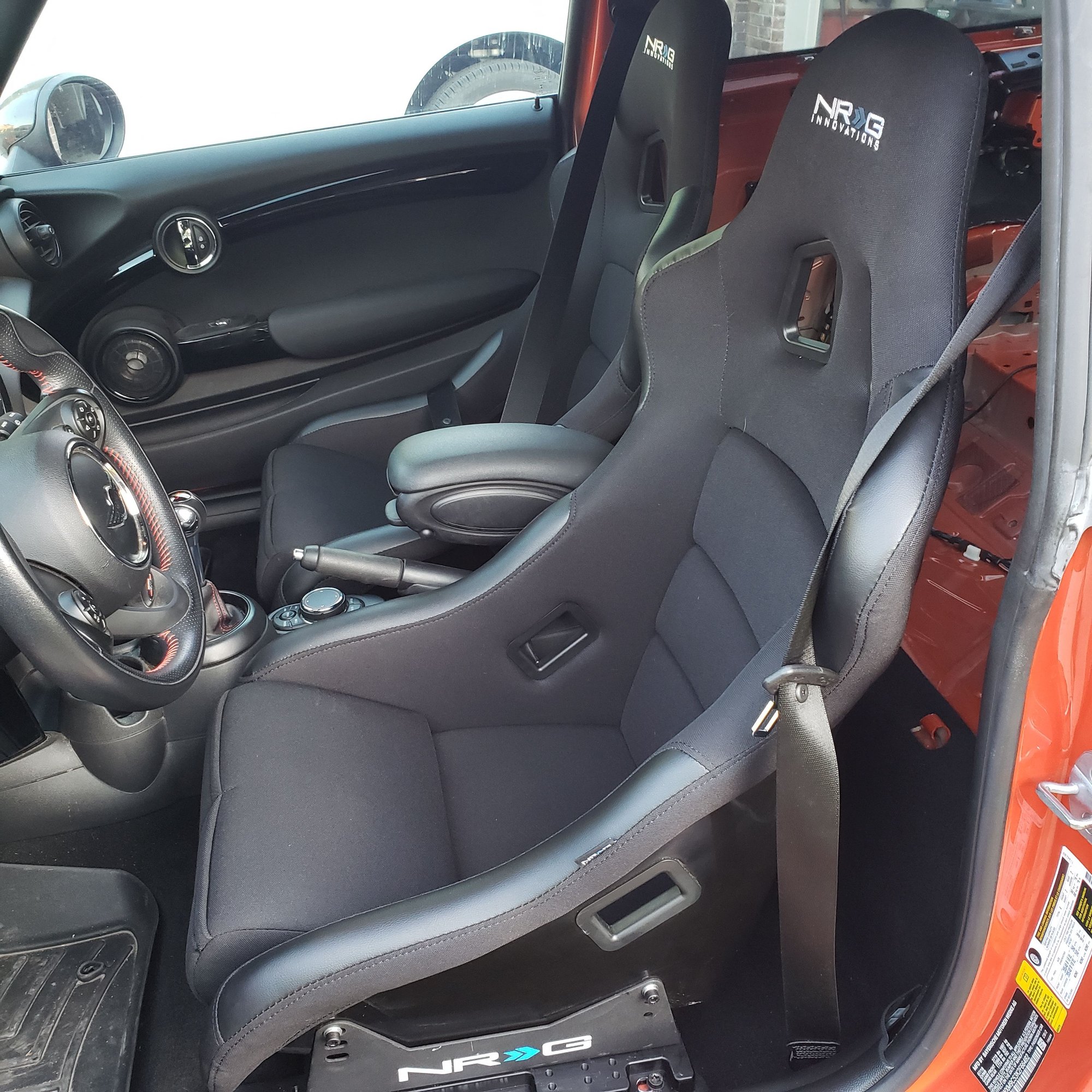

Well I got both seats installed with minor adjustments to the Macht Schnell Mounts. I did have to drill One Hole and Thread The Hole near the back of the mounting aluminum and it worked!!!
