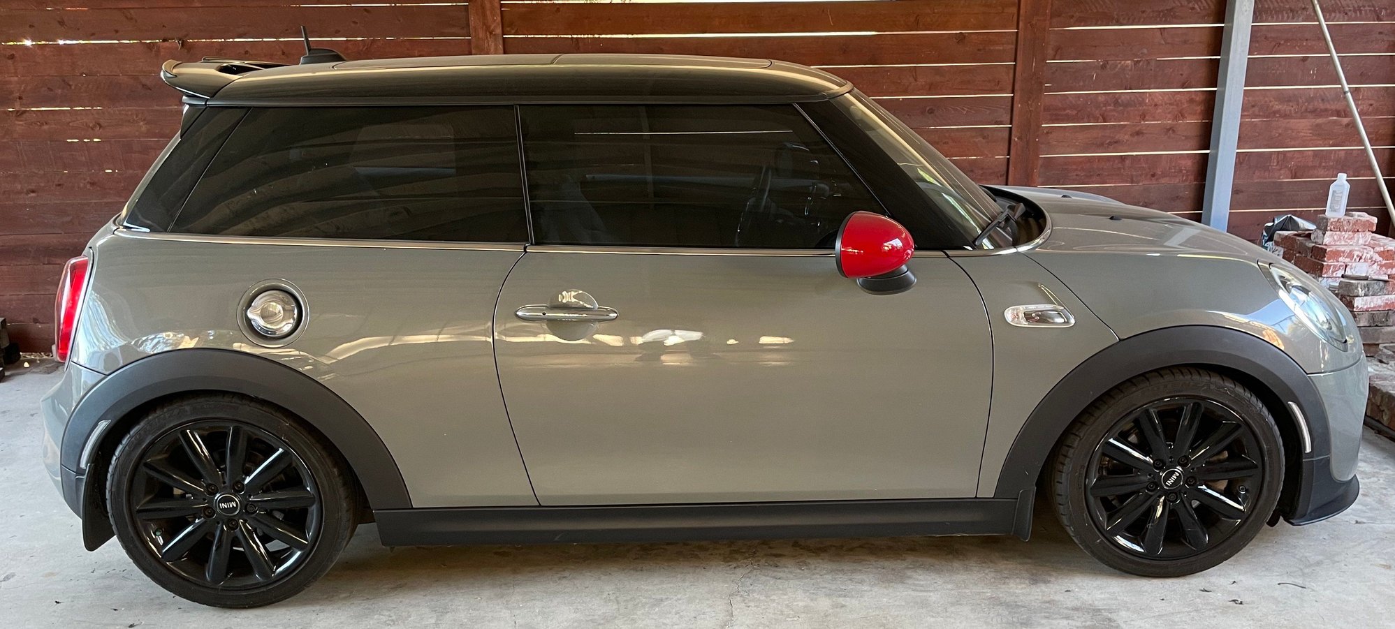

Finally got around to doing these.
Went with clear, as they seem, to gel better with the clear side turn signal. Also its a reflector.
The rears were easiest, just pull back the inner fender liner, heat the lamp, push it in to release, remove the
3M adhesive, popping the new one from inside.
The front, I just partially pulled the arch off from the bumper to the top.
