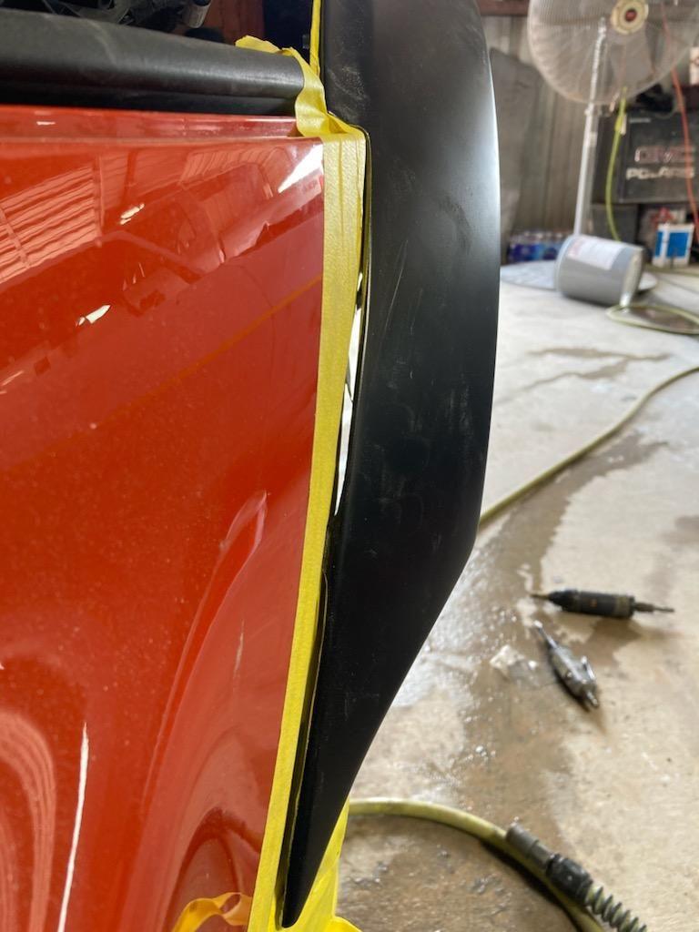

NOTE: The Aesthetic Wheel Flairs ( F56 F57 Aesthetic Widebody Flares w/o PDC (keepitaesthetic.com) ) do not come as an easy well-fitted "bolt-on"...Unless you are ready to CUT AWAY some fiberglass and ADD fiberglass elsewhere...find a way to attach since the "tabs or clips" are NOT DONE RIGHT of NOT PLACED RIGHT...Be ready to do a lot of work...
Mine will end up coming out great after MANY HOURS/DAYS or adjustments!!! Doing some Metal Work...Fiberglass Work...Paint/Coating. Pics will be after We are finished ... I am racing this weekend in Beeville Texas in a 2020 Camaro SS 1LE at the

Just a teaser pics of the start of tweeking the flairs to fit properly...adding fiberglass where needed to fill in open space...adding steel in wheel well near the outside area of fender well...and some other tweeks. Next pics when posted will be at the finish...
