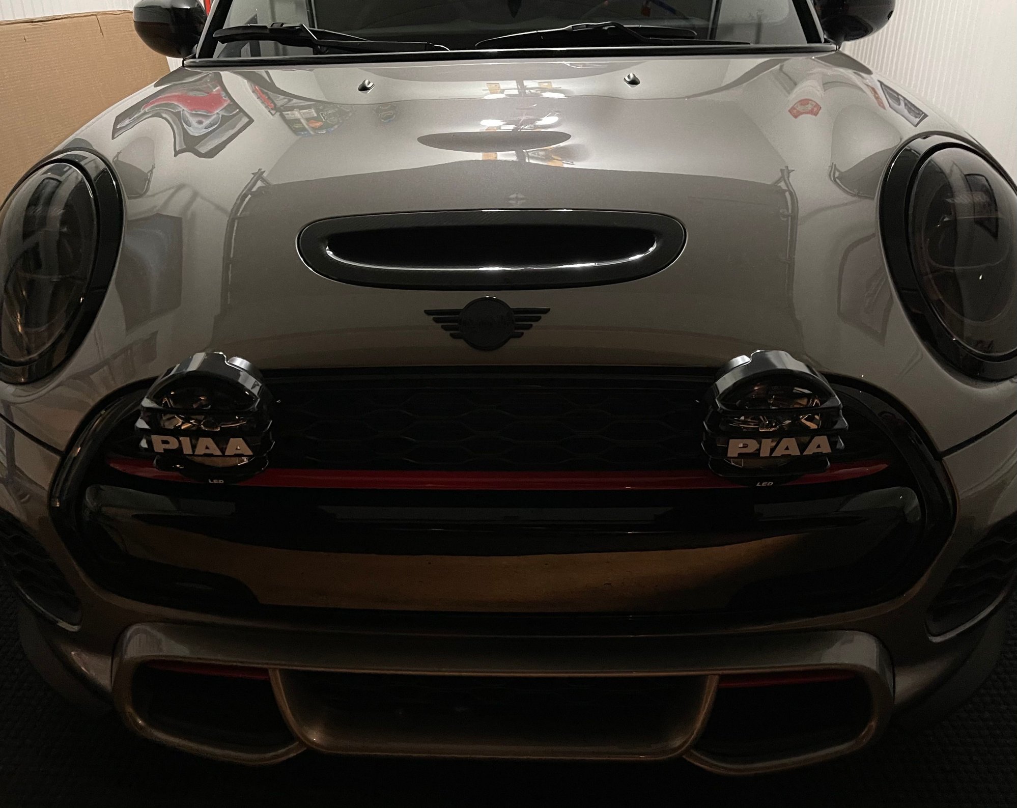

Here’s a picture of my PIAA 5” LED Lights...
