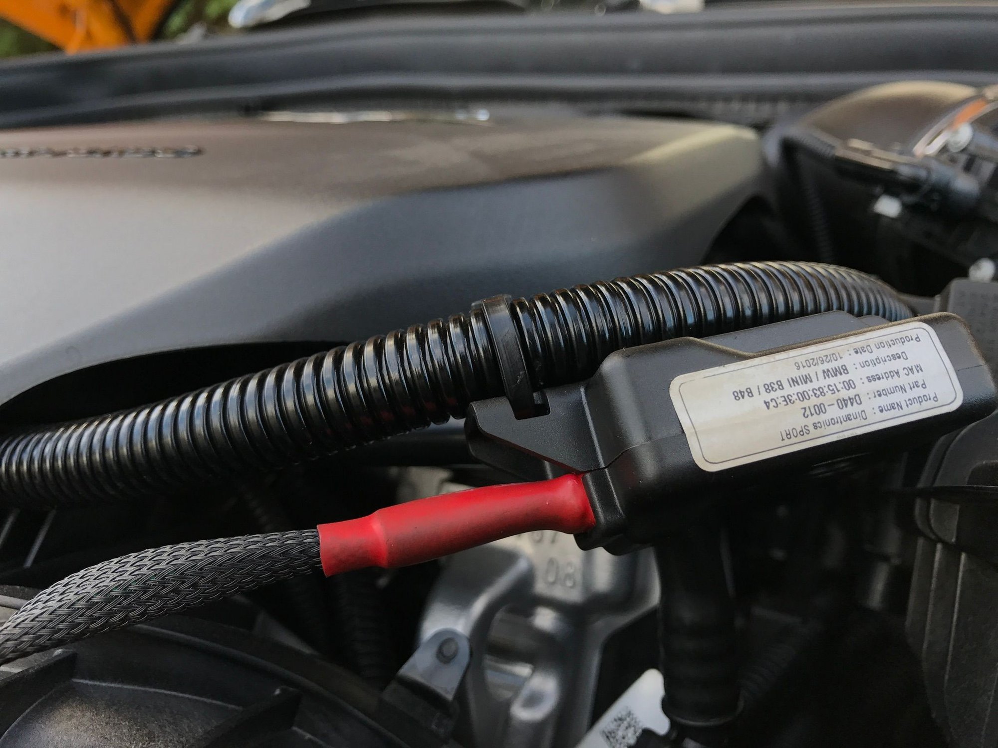

To be fair, Bluetooth is radio and the module has to communicate with the phone across an huge chunk of metal (the engine), metal hood and firewall. When I had this, I positioned the module as high as it would reach in the engine bay, and my phone was mounted by the tach. If you secure it down near the sensor or have your phone in a cup holder or lap, the engine is going to interfere big time. The only hope for communication is packets bouncing off the hood back into the car, and that hood has enough going on that multipath interference is a thing.
This worked well for me:
DINANtronics Sport module installation location

I put mine on the metal next to the battery. Proximity helps for sure. But, at best, it's funky with my iPhone.
Photos here:
https://www.northamericanmotoring.co...ml#post4262152
