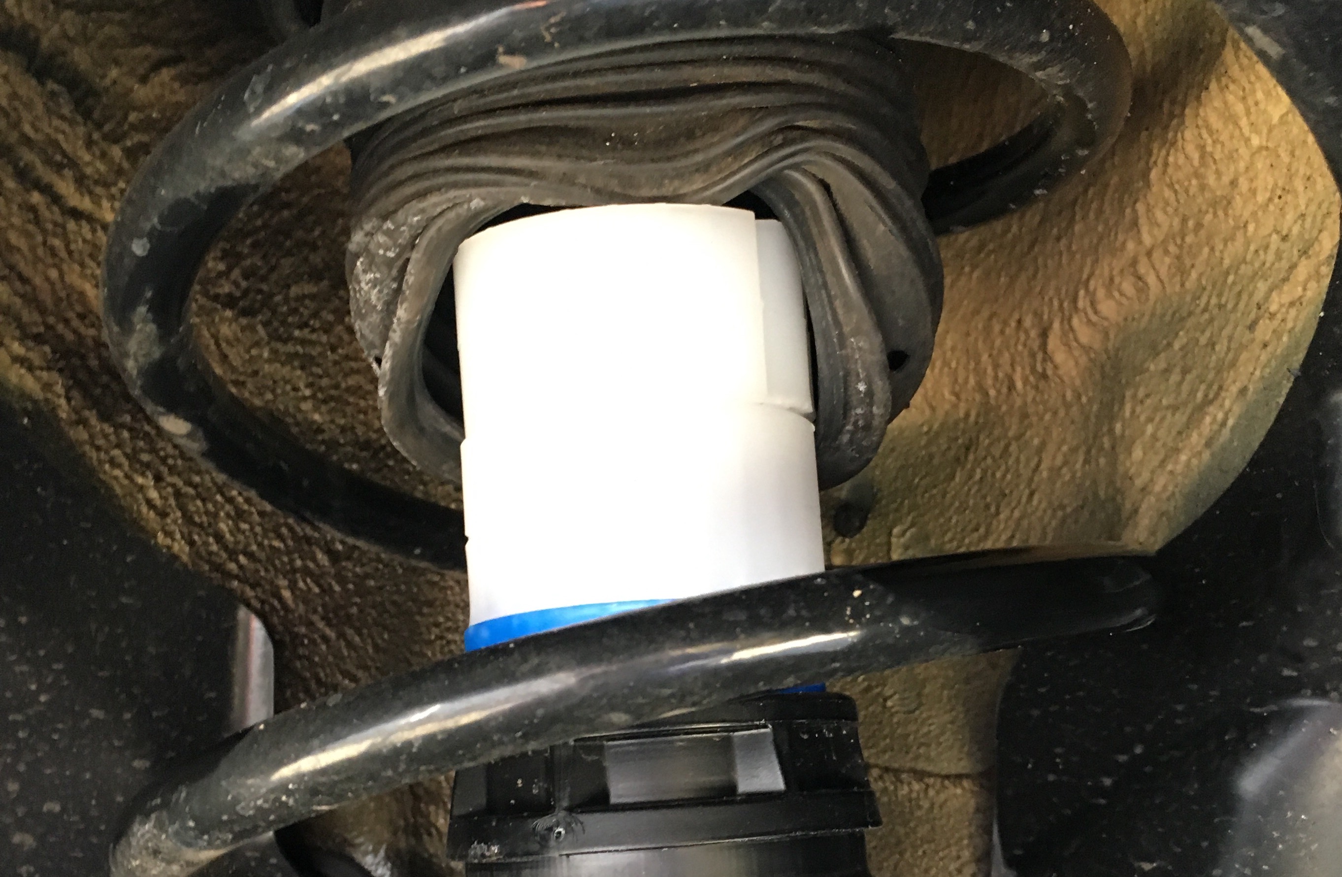

I picked up my new F56S back in the beginning of December. I was very excited about it, as it was configured to match my old R53, with the exception of cloth seats and no rally lights. When I drove it home, the ride seemed firm, but not punishing. I thought to myself that the ride was pretty good with the stock runflats, as compared to my R53 with non-runflats. Over the course of two weeks, and 500 miles, I drove it around with a grin on my face, in and around NYC with the crappy roads it's known for. Overall, the ride was firm, but certain bumps (like speed bumps) seemed to be unduly harsh, much like my R53, to the point where it felt like there was no suspension at all. Around that time, I also noticed that the car seemed to be sitting rather high in the front - not level, but higher in the front than the rear. I measured the front and rear wheel gaps and heights, and compared them, and of course, found the front to be higher. I even looked up the MINI specs, and measured the front height using it, and found that the front sat 1-1/2" to 2" out of spec. I thought that maybe the suspension had to settle since the car was new and tried not to worry about it. But it kept bothering me. I researched about new suspension springs settling over time, and tried to placate myself that it was going to happen with my MINI, even though the consensus was that new springs typically do not settle. I also read about shipping blocks being left on delivered cars, but dismissed that immediately, as I thought "no way it could happen to me". I ended up losing so much sleep because of how the car looked with the front sitting so high, I decided that I would make an appointment to bring the car in to have it looked at - maybe the wrong springs were put on the car (F54, F55 springs instead of F56?). All I knew was that the front was out of spec, and the dealer would have to do something to correct it.
(see pic # 1)

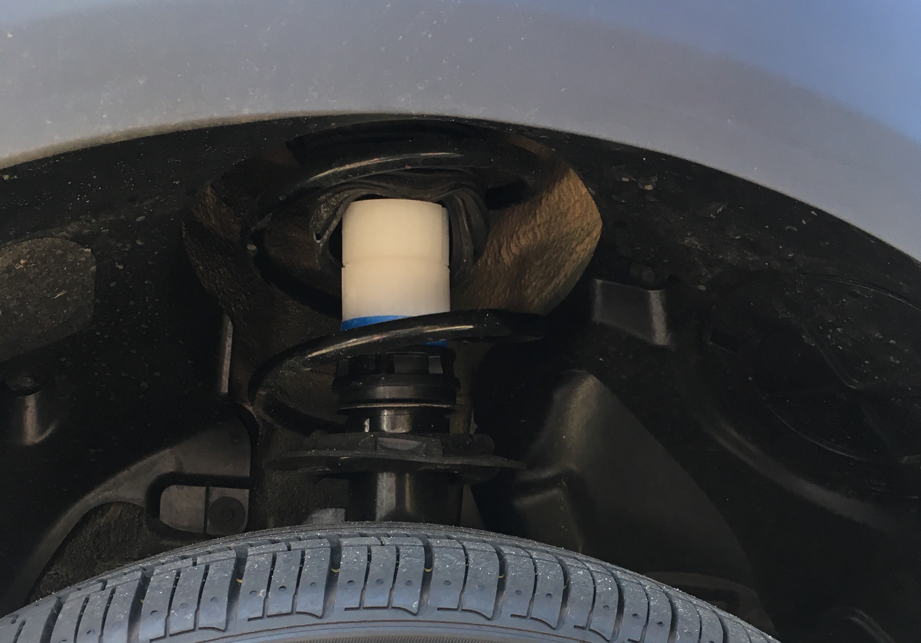

One day after Christmas, I was again measuring the front height, and was poking around by the wheels and noticed that the dust boot was pushed in on one side. So, being OCD as I am, I went to "pop out" the part of the dust boot that was pushed in. To do so, I had to lift the dust boot to get behind it with my fingers - that was when I noticed some blue and white plastic discs surrounding the shock piston. WTF? I lifted the boot some more, and said to myself "holy sh**! They left the shipping blocks in!".
(see pic # 2 & 3)

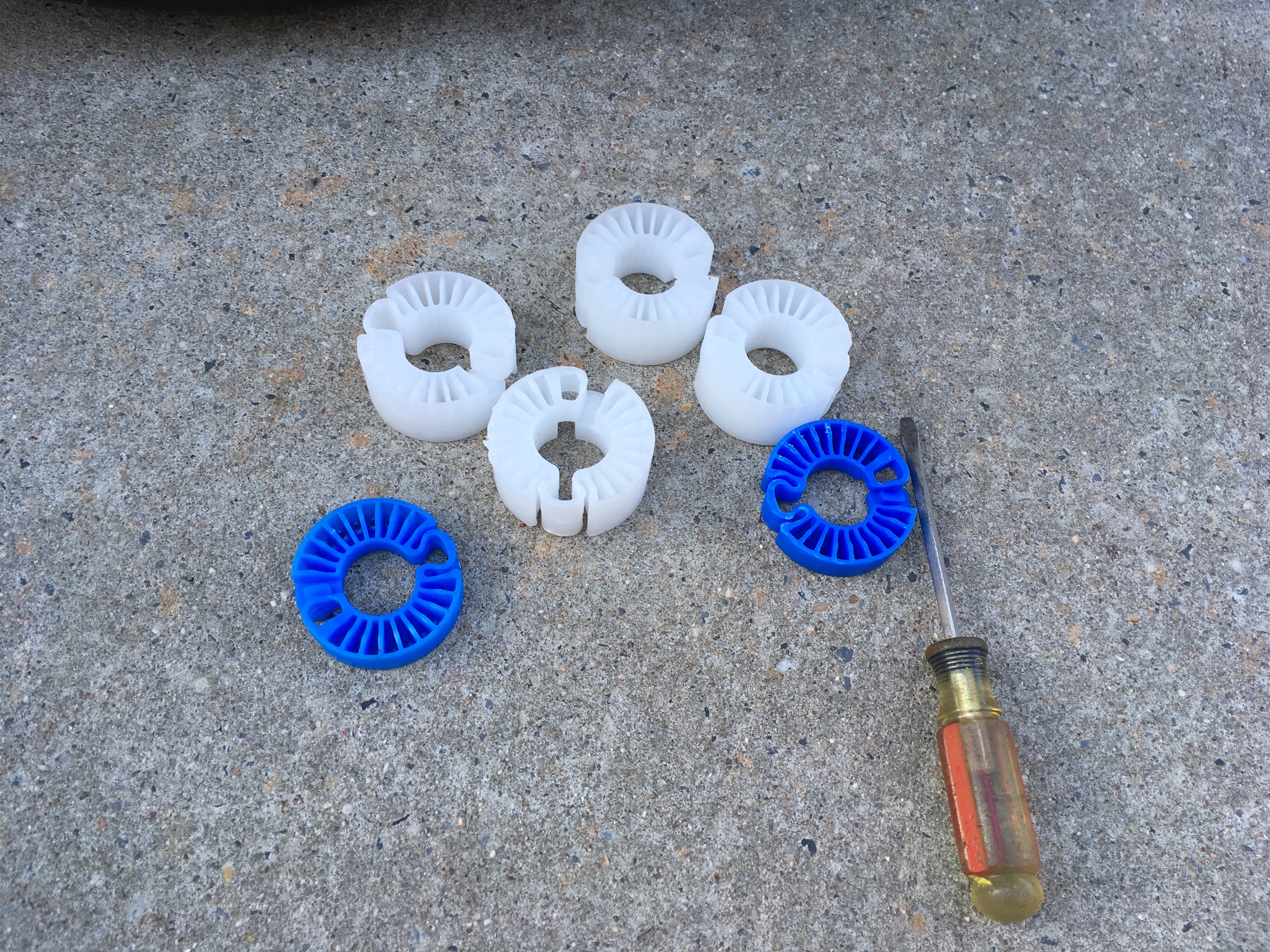

I immediately went to get my floor jack, and a screw driver, and pulled out (6 in total) shipping blocks from both sides of the front suspension.
(see pic # 4)
After removing the blocks, I remeasured the front height, and "bingo!", height was in spec. The MINI now had its typical forward rake that it's supposed to have (with equal wheel gaps front & rear). The ride became SO much better, even with the stock runflats, not even close to the harshness of my R53. Bring on the speed bumps!

This are installation blocks, they protect the shaft during spring assembly.
Should have never left the factory with those on.
The PDI tech wouldn't know about those.
Respectively disagree. These blocks restrict suspension movement and allow the vehicle to be tied down tight during shipment, and prevent bouncing during the voyage across the pond, which could lead to the vehicle breaking free in the shipping hold. Dealership admitted that their PDI tech missed it, and that he did not check it off the PDI checklist. (If it was a factory issue, I'm sure they would be quick to pass off the blame to the factory, as opposed to admitting fault.)
Actually it is normal for BMW and MINI to ship cars with shipping spacers. It was always part of the PDI to remove them.
Heck I remember when I worked at the dealer and we had a car in and found the spacer in it from 11yrs prior.
A couple years ago I had a guy at the Dragon have me do something and I found them in his car still and it was like 5 yrs old. They were smashed and wedged in there still, but had to fight them out. Often wonder what those people think when they drive it after owning it with them installed for so long.
