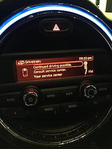

Got this "drivetrain check soon" message today, a couple days after I installed Dinan sport for my F56. Should I take it to the dealer or it's something related to Dinan? And what does it mean?

I'd disconnect and drive for a few days and see what happens. If you have an OBD reader check for codes. Some dealers are cool with Dinan, others might not be. Try to find that out. You can also contact Dinan and see what they say, having codes would be of help.

My Dinan gave me issues after the dealer updated the DME.
Car wouldn't start, then when it did start, gave me that error, and 10 different codes.
My replacement Dinan Sport is on a UPS truck as we speak.

Thx folks! Will contact Dinan. Also bought a OBD reader on amazon and made an appointment with dealer next Wed.

Hooked up OBD2 reader and there is no code. I guess it's because it's not a CEL but a MINI specific message. Contacted Dinan and waiting for their reply.

Dealer found fault code 20A503 and they said looks like TSB SI M12 04 14 applies. Do you guys know what device I can use to get the fault code of MINI? I used OBD reader but no code was found. Also, is there any place I can see this TSB? I don't mind paypal you to get it.
