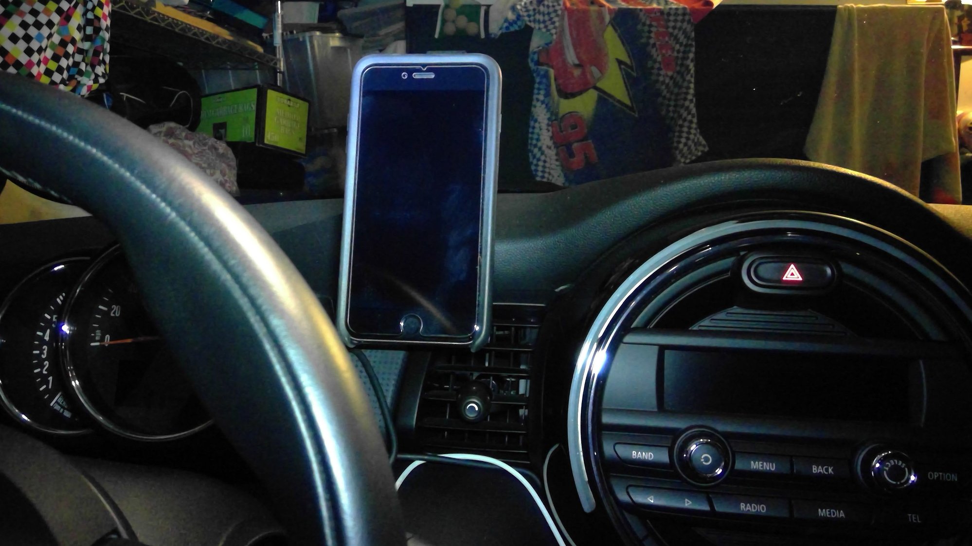

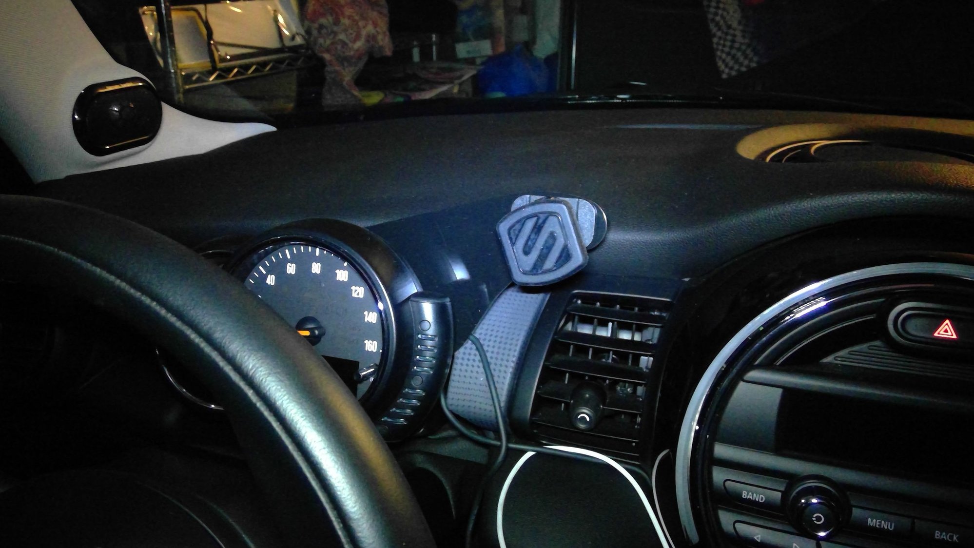

cell phone holder: brodit procliop...i made it a bit more custom by adding a magnet to it my phone snaps to it easily.

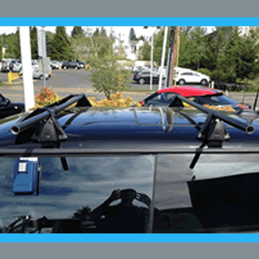

Mini doesn't make them. You have to go aftermarket. Yakima makes a part called a Q Tower. You'll need Clips that are shaped to the roof of your car and are attached to the Q Towers. They basically hold the rack onto your car by gripping the roofline under the rubber trim. The Q Towers sit on the roof top and pull the clips in, creating grip. No holes no drilling. I've used Yakima racks for over 17 years. Good quality and then you'll be able to attach most anything to them.
Here is a picture where you can see the clips attaching under the trim. They are attached to the Q Towers and then the cross bars attach to the Q Towers. The bars in this picture are way too long.
