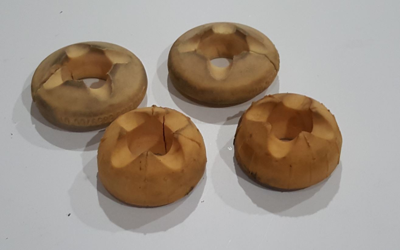

I purchased my F56 S back in late 2014. Back then there were few manufacturers of lowering springs for the F56. H&R was one of them. In the instructions there was no mention of bump stops or cutting them. After having them installed it was apparent that the car was riding very rough and harsh. I tried to live with it for several months but it was awful. Let me mention that I like my cars to have a firm/stiff ride, but this was too much. I started hearing that the NM springs rode smooth and that others had switched from H&R to NM for this reason. But in reading through the NM instructions I noted that NM stated that it was very important to cut the bump stops and it got me thinking. Maybe I should try cutting the bump stop to see if it helps. It made a huge difference. What was harsh and bouncy is now smooth and compliant. I should also mention that the car has EDC (electronic dampers). It even allowed the car to sit lower now that it wasn’t sitting on the bump stops. I would say it is about ½” lower now, and rides much much better, and looks much better also. It is a PITA to cut them in the car but worth it. Attached is a picture of the cutoff pieces of the bump stop. Also attached a copy of the NM instructions for reference.

As mentioned in the OP........yes, but it is a PITA. Mainly getting the dust covers back on.
