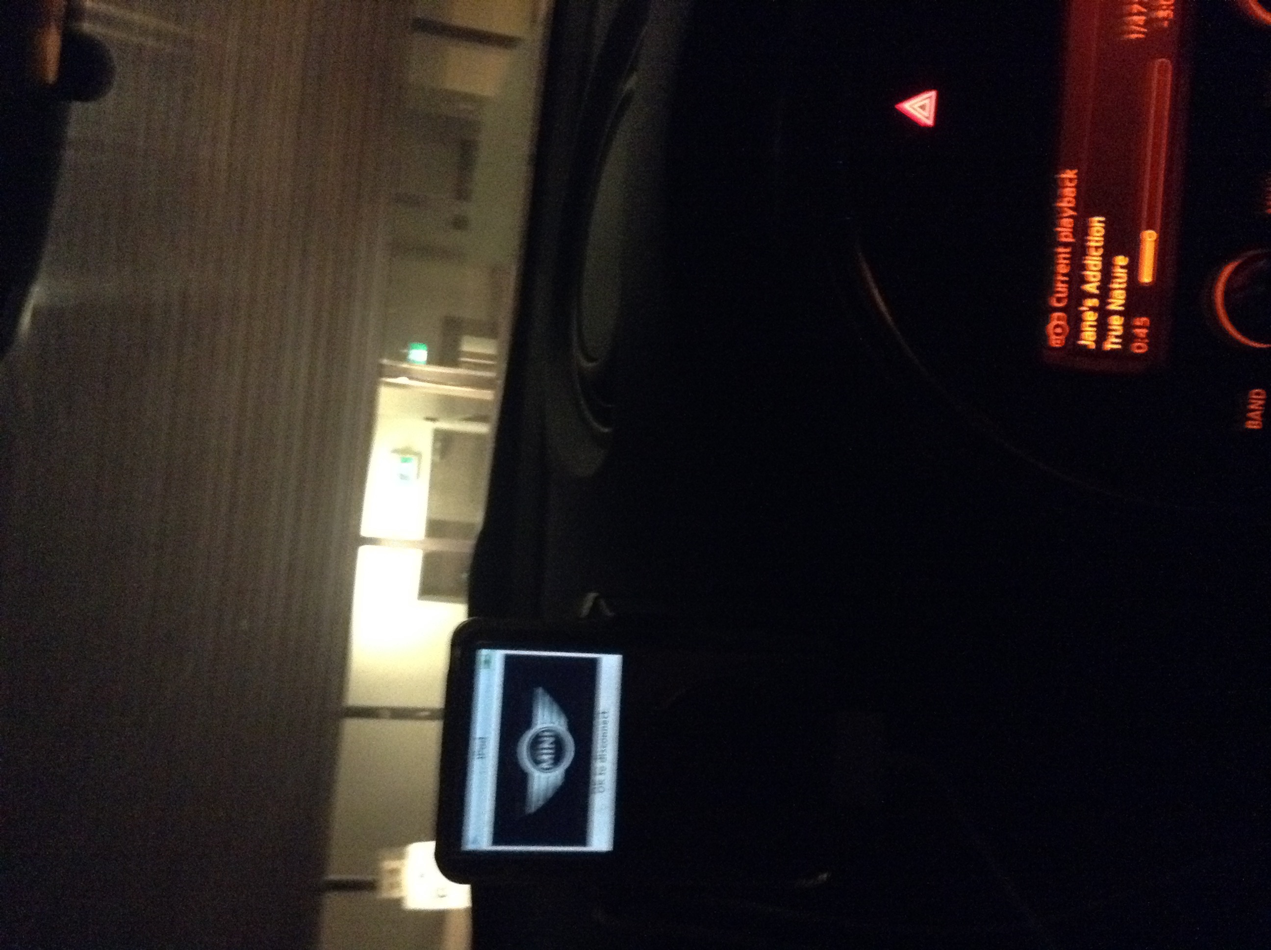

The iPod Video wasn't brilliant, I did get it to work but I had a few problems.
It was low on charge and the battery is weak. When I plugged it in, it lost the rest of its charge and kept rebooting.
I charged it up for a couple of hours on my computer, then it worked, it even shows a nice MINI logo and it played an album I have hardly listened to which I like more now than a few years ago.
The dock connector is loose and even with the low mileage Apple cable it still disconnected if anything bumped the wire so I had to take it out of the cradle and lay it on the seat.
When I got home, the battery wasn't fully charged. I'm not sure if it was never fully charged or if that has to do with the loose dock or the weak battery, but I think it doesn't have enough current for iPod.
