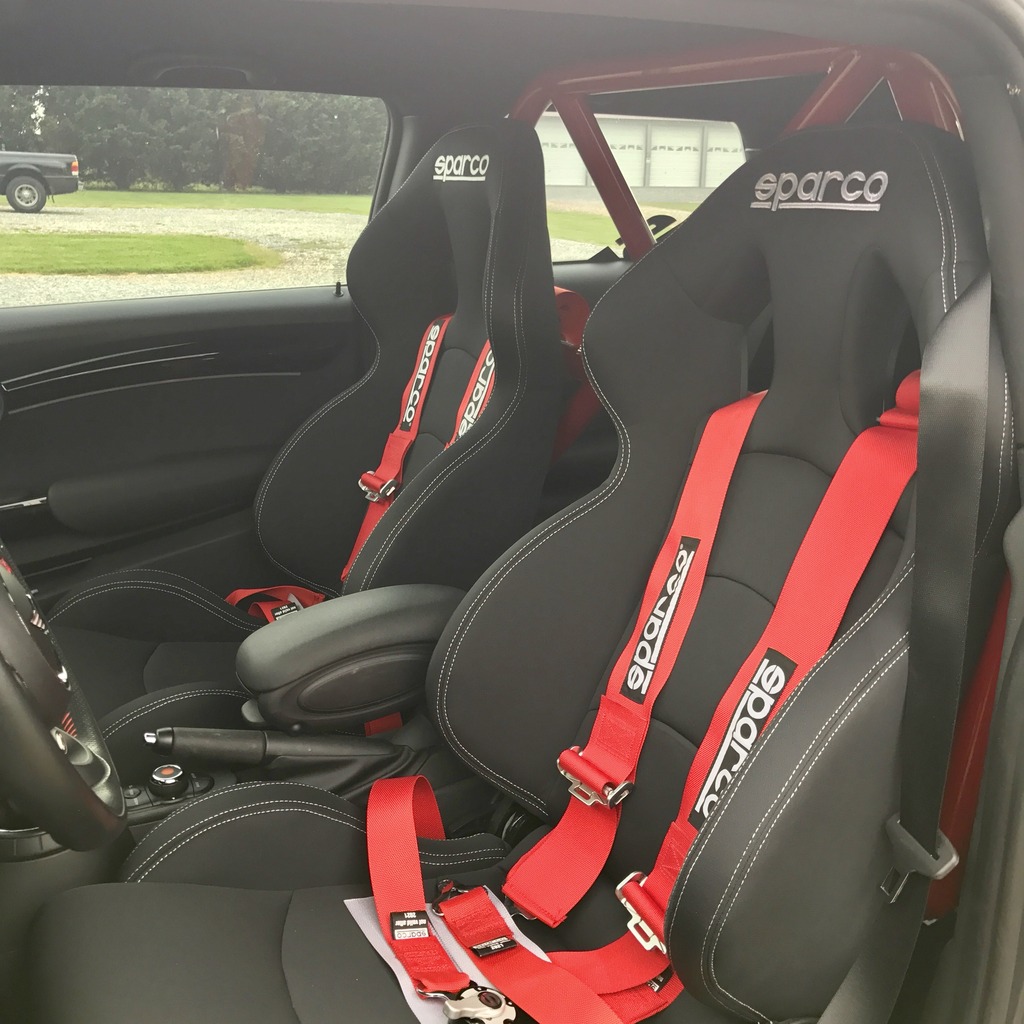

Sparco seats, rails, and modified Sparco R53/R56 bases. Still haven't solved my driver/passenger restraint warning problem yet.

[QUOTE=vetsvette;4301330]Sparco seats, rails, and modified Sparco R53/R56 bases. Still haven't solved my driver/passenger restraint warning problem yet.
The resistor didnt work?

The chassis to seat connector is a strange piece. Can't tell what's what with it. Wasn't the kind of plug/setup I was expecting. I need a good wiring diagram before I can do anything.
Interesting. There has to be a way to bridge that or trick it somehow. Can you delete the light with a scanner tool?

I'm sure there's a way, but I need a schematic before I can do anything. If nothing else, when I have said schematic and can ID the individual wires in the chassis harness, I'll remove the connector and solder/heat shrink the resistors directly to the wires. I won't be going back to the stock seats so no reason to keep the connector.
