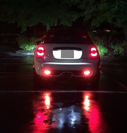

Took an alternative route to a new $150 switch and programming - wired the rear fogs to tail lights. I had to replace the original incandescent bulb with basic 921 LED, because rear fogs are blinding otherwise and generally illegal unless you're driving in heavy fog/rain/snow.
