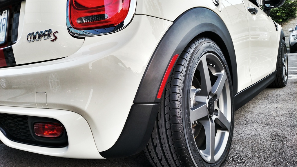

I have NM's on mine and love them.

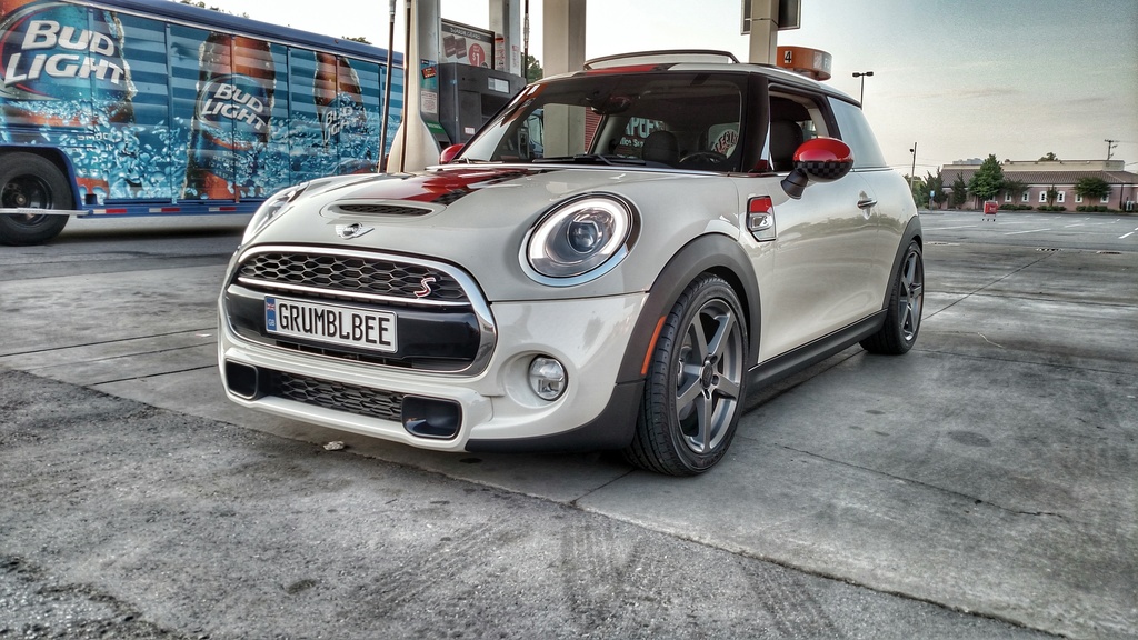

NM still seems the way to go
Old Jul 10, 2015 | 07:04 AM
Posts: 36,758
Likes: 2,548
Yes, and looks great on your F56. Love those pics.
