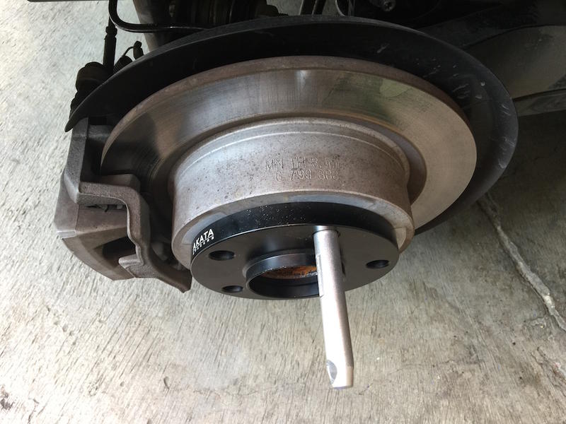

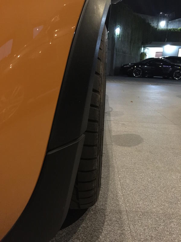

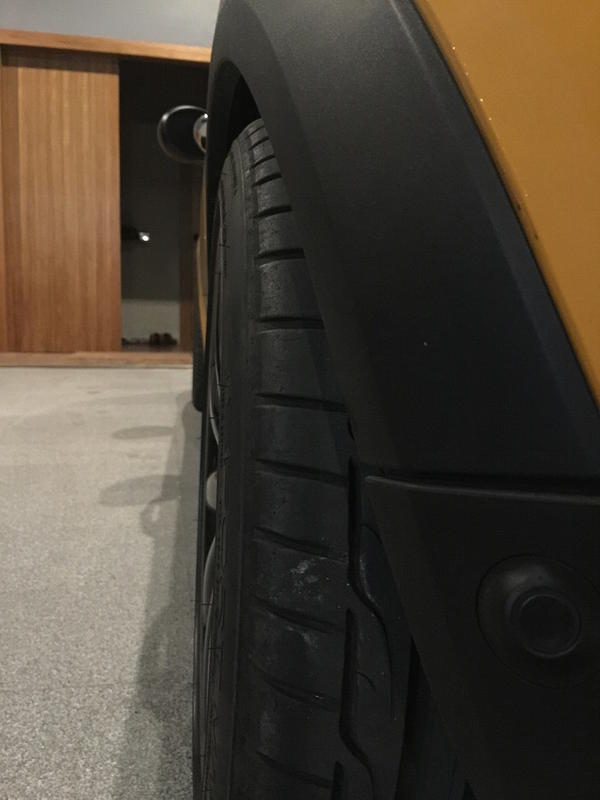

Just an update for those who are thinking of getting spacers. The Merc/Audi spacers works great!
Here's my setup:
Akata Spacers 5x112 CB 66.6 (13mm front - 15mm rear)
Turner BMW Extended Lugs (M14x1.25x40mm Front - M14x1.25x43mm Rear)
Burger BMW Wheel Pin and Jack Pad (Helps during install)
I went with the cheap spacers which turned out to be decent quality. Plus unlike spacers for Japanese cars, spacers for our cars don't really carry any load anyway.
For those looking for good quality spacers I'd recommend going for the 42DraftDesign spacers, Made in USA, and should be lighter in weight since they machine big grooves on the spacers.
Lugs on the other hand are very important and I know the Turner guys would only sell quality lugs. I've read too many horror stories on cheap lugs breaking during normal driving....
Pics attached!
