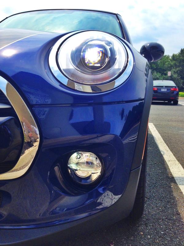

Here's a photo so show how they look, sorry it's so bright out.

Can you please explain to me what the picture shows? Have you switched out the bug light bulbs for the LED's in the Amazon link?
Was it a straight swap?
