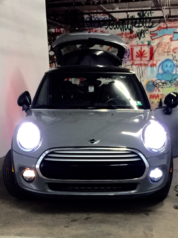

Just swapped out my parking lamps for LEDs. Perfect color match, and no warnings so far from these CANBUS bulbs.

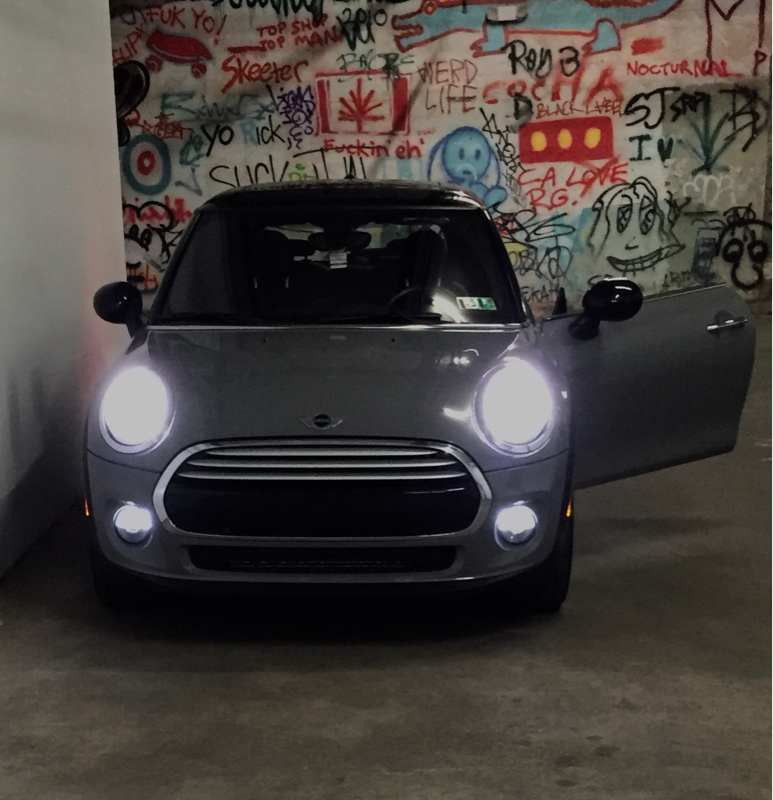

Here is another pic, illustration the "before" vs the "after":

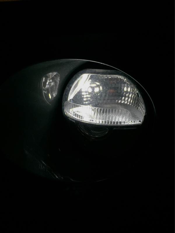

Brightness turned way down, post photographing.
Attachment 108010
just to overall clarify here, this is for those that did not opt for LED fogs, right? i just took a step out and my headlights, upper fog parking light and lower fog light are all the same color. i went with the led headlight/fog light option.
Old Mar 25, 2015 | 07:55 AM
  #40
darex's Avatar
darex
Joined: Feb 2005
Posts: 837
Likes: 22
Correct. I have the LED headlamps with cornering lights, but NOT the fog lights. We get some useless amber parking lights down there, that do NOT match -- but now they do. :-)
