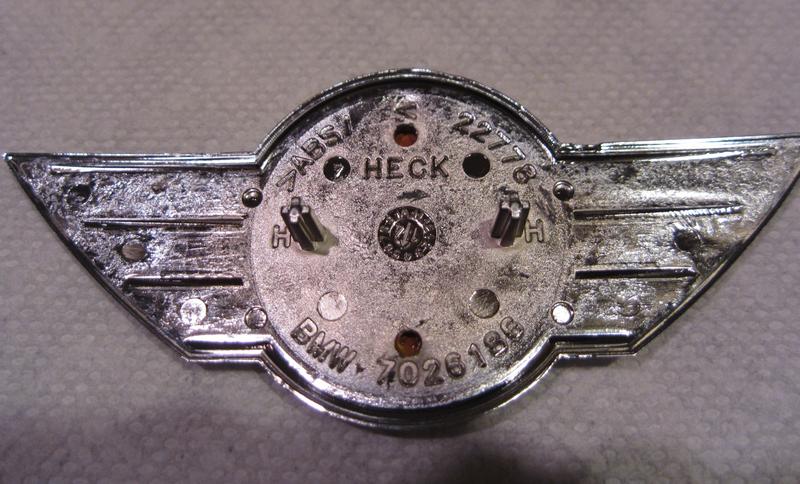

1) First I took the rear emblem off the car. It is easier to work with it and pry on it while it is on the car. The replacement doesn't have the emblem so you need to move it over. I used my heat gun on low setting to warm up the adhesive. A hair dryer may work too. I put some painters tape on the hatch grip to protect it from the heat. I thought the emblem was made of metal but it is really plastic so careful with the heat and the force you use to get it off. It is on with 3M double stick foam tape. I used a piece of dental floss to get behind and then I used a nylon trim removal tool and it came off pretty easily. You have to remove the remaining tape from the back. Then get new 3M molding tape to attach the emblem to the new trim. You can get this at Autozone. Trim with a razor so the tape it just inside the edge of the emblem.

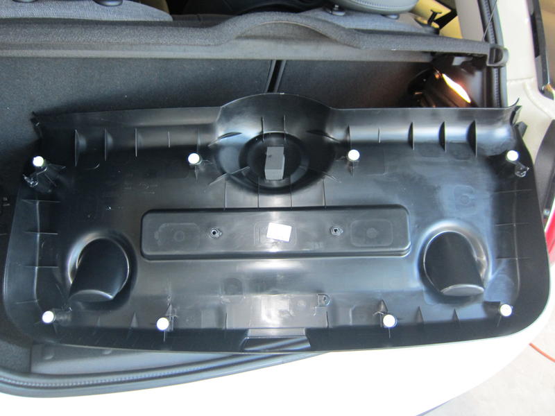

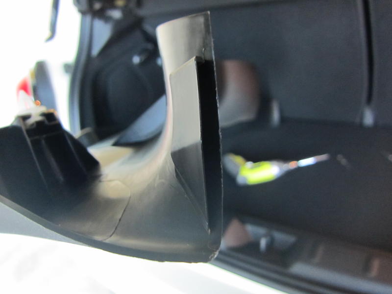

2) Now you need to remove the black trim piece on the inside of the hatch. There are two black screws (Torx-25) to remove. Then there are eight trim tabs holding the lower trim piece in. You can see their position in the pic. The trim that runs up around the window is slotted into a groove in the bottom piece. It will slide out when you release the main trim piece. I used some nylon trim tools to get under the trim. The plastic trim tabs are in their pretty snug but they will come out.

7) Reinstall the bottom trim piece. Make sure the white trim tabs are correctly in place, they could have moved when you removed it. Make sure you align the groove in the lower piece with the tab in the piece around the window. Once the tabs are aligned a firm hit with a close fist or palm will insert the trim tabs. Make sure all 8 are inserted.
8) Replace the 2 black screws

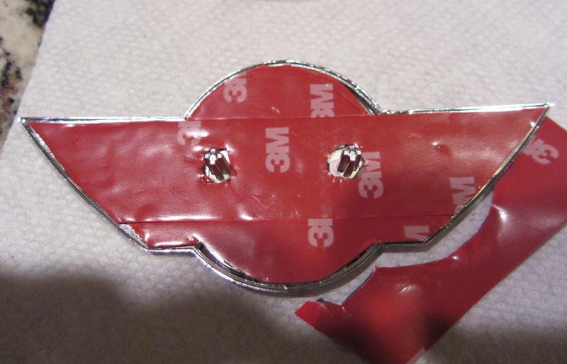

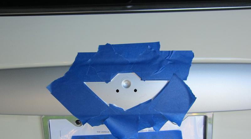

9) Remove the backing film from the tape and stick the emblem back on. The alignment pins do a pretty good job of aligning things. I had to run out and buy the tape so it was dark by the time I finished. But it really looks nice on the Pepper White/Black Roof car.
