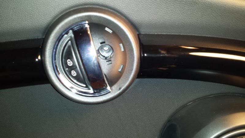

2) Remove the small trim cup behind the chrome interior door handle. It's a small, half-circle cup thingy and comes right off with a little plastic pry tool. Remove the torx screw behind it.

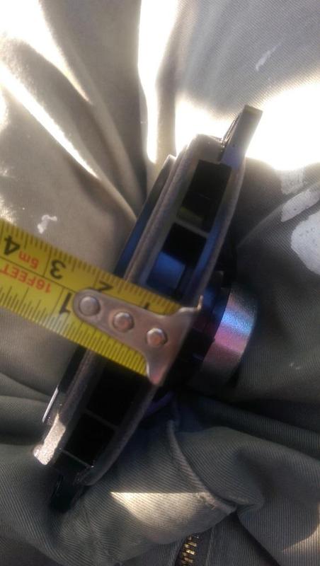

Well here are the "big magnet speakers". These are not quality believe me!
Can't wait the hear the Focals. You guys should know how much they make on the manufacturing. Cars cost are all design and setting up the line. Bet they pay $6 for each HK speaker....
