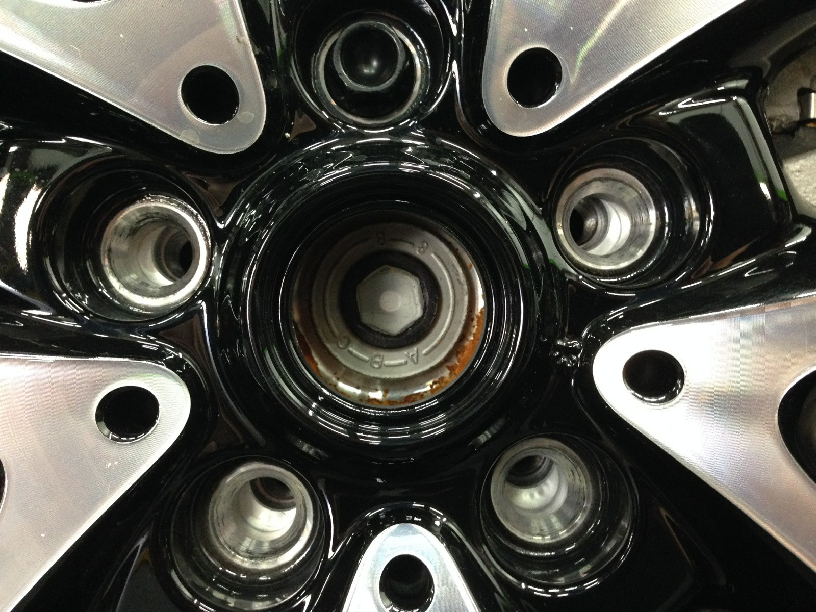

VicSkimmr's Avatar
VicSkimmr
Posts: 2,278
Likes: 14
From: Myrtle Beach, SC
Apparently everyone I've talked to has been dead wrong :(
Here's the 19" Countryman wheel overlaid on the F56 hub
Old Apr 8, 2014 | 05:05 PM
R99's Avatar
R99
Joined: Jan 2008
Posts: 596
From: Lake District, ENGLAND
Hmm, so not 5x120? :(
What pattern does the photo point to??
Old Apr 8, 2014 | 06:16 PM
VicSkimmr's Avatar
VicSkimmr
Posts: 2,278
Likes: 14
It's either 5x112 or 5x114, neither of which make any sense to me.
