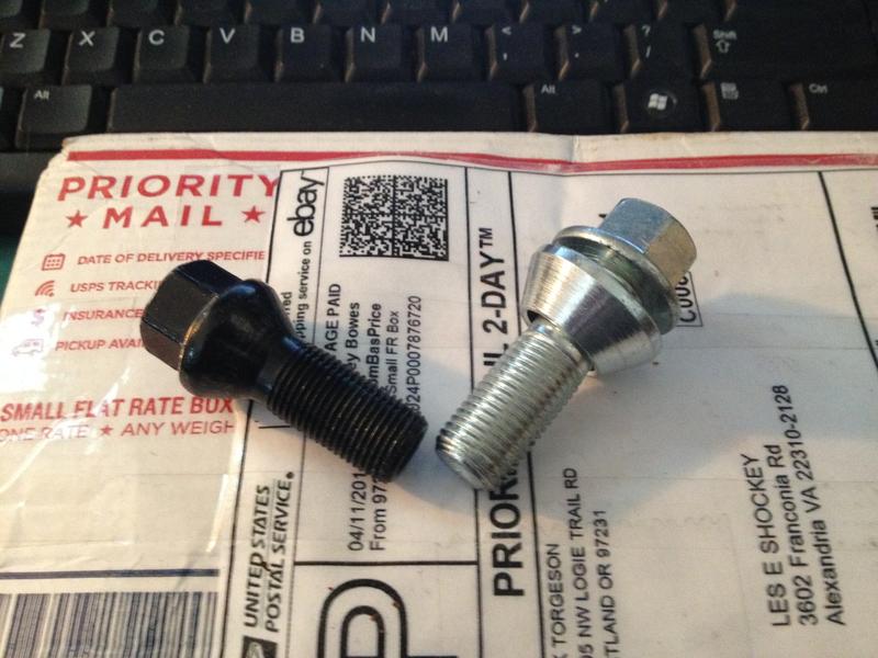

Looks like 5x112mm bolt pattern is the winner. ordered wheels with a 114.3
pattern and some wobble bolt designed to convert 5x114.3 to 5x112.

Do not order wobble bolts. They do not work. 14mm thread yes but it is a course thread and will not fit the Mini. Mini uses a fine thread. $90.00 shot.

Do not order wobble bolts. They do not work. 14mm thread yes but it is a course thread and will not fit the Mini. Mini uses a fine thread. $90.00 shoot.
